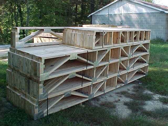

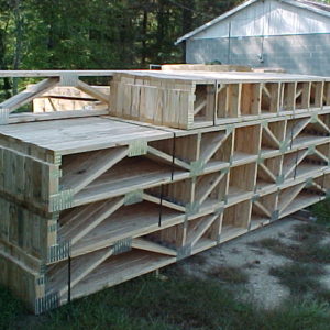

    When you say "open truss" I assume you mean a wood webbed floor truss. There aren't really beand names for these. Just tell 'em you want wood webbed trusses, and make sure they don't think you're talking about I-joists.
    I attached a pic of a pile of wood webbed floor trusses just to make sure this is what you're looking for.
    I'd start by talking to a lumberyard about getting them. (Not one of the big boxes) Truss plants may or may not sell direct to consumers in your area. that varies from one company to the next. But a lumberyard can get you headed in the right direction and provide limited assistance.
    If you want to run your HVAC lines in the trusses, I wouldn't suggest getting trusses that are less than 18" deep. Anything shallower and it's a struggle to get things in there.
    You also need to have your truss guy meet with the HVAC guy if at all possible. The trunk line layout needs to be planned ahead of time.
    I've been called out many times after floor trusses are set by HVAC guys wanting to cut out a bunch of the webs so they can run duct lines through. (you can't) I Can't emphasize this strongly enough. Plan ahead or you're asking for headaches.

      Hey Boss, what is the function of the notching at the end of those trusses? Is this for exterior sheathing or some sort of rim piece?
        BossHog | Aug 10, 2005 05:47pm | #3
        The notch is there to allow for a "ribbon board".Check out the attached pic and I think you'll see what I mean.

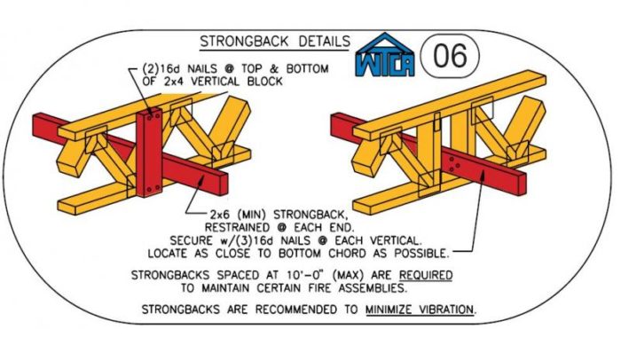

          Does that back bracing run continually across all trusses in your example? What is its purpose?BTw, I'm curious why you recommend against Big Box trusses.

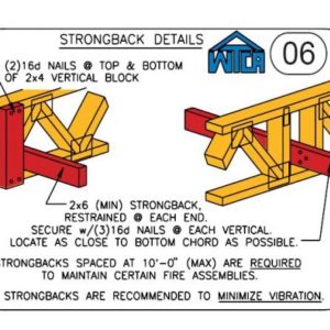

            "Does that back bracing run continually across all trusses in your example? What is its purpose?"
            Do you mean the thing that says "Strong (stiff) back bracing" ?
            That's iinda like "X" bracing on floor joists. It ties them together to help prevent vibration.

            Sorry about the typo. I was referring to your suggestion that one not buy trusses from the Big Box home improvement stores such as Home Depot. Just curious why that is.As for the "Strong (stiff) back bracing", is that just a continuous 2x member running perpendicular to the trusses? I'm asking because I will soon be installing floor trusses on a renovated section of my old home. Using 14" 2x4 trusses spanning 18'. I'm in the process of cutting out the old flooring and joists. I hadn't ever seen that kind of bracing used in any of the new homes I have been in, so I'm kinda of curious as to how and where its placed..My engineer spec'd the loads for the trusses and after shopping around I purchased from Menards, one of the local Big Box stores. Their price was more than a $1.00 a foot cheaper than my usual source, the local lumber yard.You got me wondering if perhaps I have made a mistake in my purchase.
            BossHog | Aug 11, 2005 02:00pm | #9
            I suggested not uying trusses from the big boxes because they typically don't provide any kind of technical assistance. It sounded like this guy could use some.The 2X6 strongbacks are recommended 8 to 10' on center. They recomment that you use at least 14' lumber, and lap splices over 2 joists.They're not absolutely required. That's probably why you haven't seen them. I sugget putting them in while you're framing. If they're in the way, they can always be cut out. But it's rather difficult to get them up in there after the house is done.

            Illustration for the weak reading-comprehension person? :)
            BossHog | Aug 11, 2005 04:00pm | #11
            Speaking of comprehension - I don't really comprehend what you're asking me...
            Women with "pasts" interest men because men hope that history will repeat itself. [Mae West]
            Nuke | Aug 11, 2005 04:59pm | #13
            You just described something to another individual, involving 2x6's being lap-implemented during the framing stages. I was wondering if you could provide an illustration so one does not misinterpret your written description.
            BossHog | Aug 11, 2005 05:25pm | #14
            O.K. - How's this?

            Perfect!
          10. pino | Aug 11, 2005 10:39pm | #16
            thanks for the illustration Boss. That really makes things clears for me.
