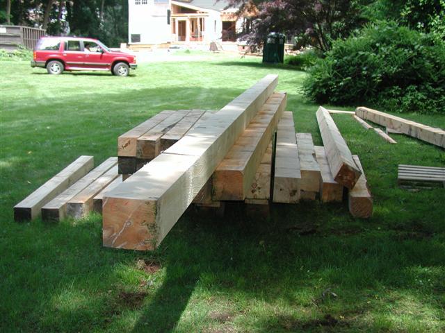

you mean like these things?????? Top one is 36' long!
YEAH LIKE THOSE!!!!!!!!! Where did you get them and how do I contact them? Tell me asap...I'm bidding ona project.If at first you don't succeed, try using a hammer next time...everything needs some extra persuasion from time to time. -ME
They came from:Charlie Pike & Sons sawmill
Hampton, CT860-455-9968Hope this helps you, but I think you'd be able to find a local sawmill.
