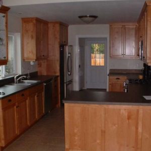

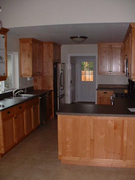

Here's my kitchen spray with a little diaphram pump
I almost that wagner for us, I went to HD to pick it up and I looked at it and the Graco baby, the Graco had a little better spec's and I know and trust the name, Wagner I've never heard much good about except that particular unit.
The graco I bought is a diaphram as well I believe, both seemed like throw away units when they wear out but for 50 more I went with the name I knew more about.
