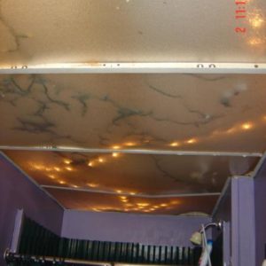

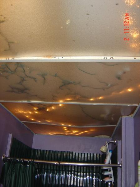

I bought a duplex at foreclosure, real slumlord kind of place. The toilet was plumbed into the tub (yeah, that's raw sewage in there), the squatters then bailed out the tub with a bucket and threw it in the back yard so they could use the shower. Bail out the tub from shower so you could use the crapper. Rinse and repeat.
The decorative xmas lights over the over the tub were held up by the sturdy drop ceiling panels...where is Darwin when you need him?
Enjoy. -Norm
Edited 3/22/2009 8:28 pm ET by VTNorm
Ceiling pic of the bathroom posted above.
You win. That is just plain nasty. Thanks for ruining supper.

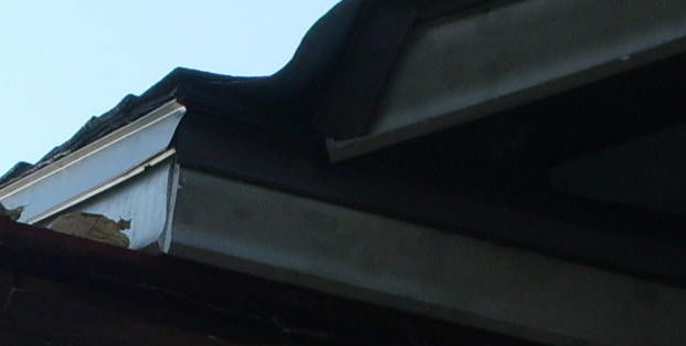

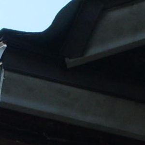

Last year I got hired to install fix a botched crown install on a Victorian exterior along the rake and eve fascia. The crown was installed:
Flat (no spring angle)
Upside down
Lap-jointed corners (don't need no stinkin' miters)

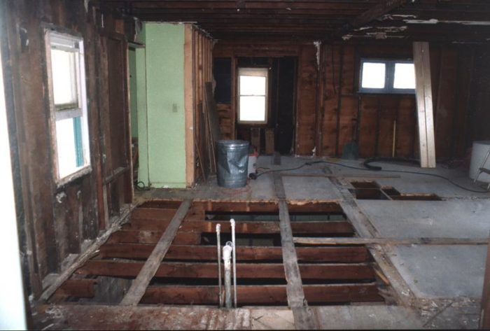

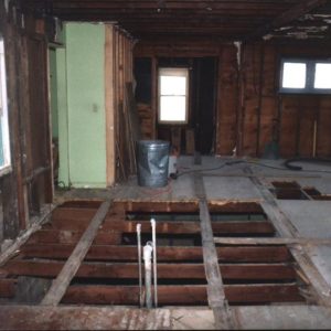

My latest find!
http://picasaweb.google.com/uknigel/FloorChop?authkey=Gv1sRgCLvEy5aAi5DzvAE&feat=email#5316211365004941122
If this picture actually uploaded, You can see the area of open floor. Three of the six joists had been cut (plumbers). The joists were 2x6 spanning 12'.

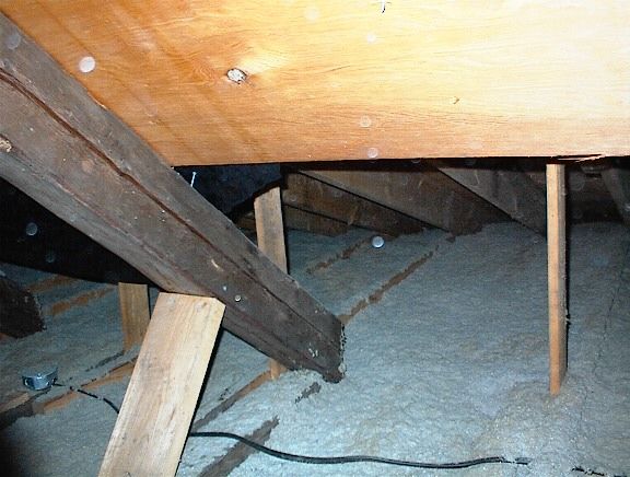

OK, here we have some 2x4 attic floor joists. As you can see, the one on the right is hanging onto that bearing wall by about 3/4." Also, please note the two junction boxes that were buried in the space. Nice.At the opposite end the joists were tagged to the rafters with one or two 20d nails, also just barely touching it. Over a 13' span, most had sagged about two inches.
Edited 3/24/2009 8:56 pm by ptp

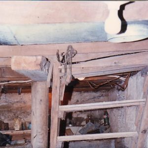

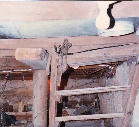

The universe has a sense of balance to it.I took apart one circuit that was fed from two diff directions on two different breakers. It went around a large room I could see after pulling the plasterboard off. I plugged shut off the breaker and tested fist recep in line and it was cold, so I started yanking. got halfway around the room and sparks start flying...Called the electricians and they got out the test gear....scratched their heads...yep, dual feed.
