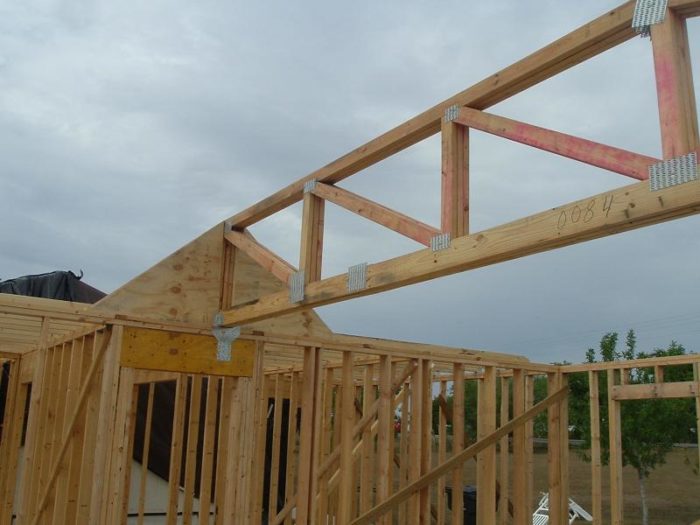

Well I installed a truss over my garage that my ceiling joists will tie into and ran into a problem. It seems the center of my garage wall is not plumb anymore by 1/2″. I guess the wall moved on me when moving the truss around. My garage corners are plumb so it looks like only the center of the wall is out of plumb. The truss has been bolted down and braced so it would be a hassle to untie it to re-plumb the center of my garage wall.
If I leave it as is will it cost me much in the long run?
Some specs. 4/12 pitch hip over garage, 26′-5 1/2″ width of garage wall,single story.
I posted some pics.
Is the wall straight at the dbl plate?

Yes it will cost you. 1/2" will show up in the overhang and it will look like a rookie built it!
Oh wait...a rookie is building it LOL!
Just pull a few nails and push the wall in the 1/2" to where it belongs. And don't whine and tell me how many nails you gotta pull...I don't care. You've already stood around scratching your head for more time than it would have taken if you just whipped out your nail puller and went at it.
Ten minutes and you'll be good to go.
Now...stop messing things up! Do I gotta drive down there and do this for you?

Well I took the advice and fixed it. I feel better now, I think.

I'm curious - Is the roof stick framed, and this girder is holding it up?You have a pretty healthy tie down on one end of the truss that's attached to a header. Are ya gonna tie the header down to something or leave it like it is?
Free advice is worth what you paid for it
Hello Boss. The roof is stick framed but the only thing the truss is holding up is the ceiling joists it is not connected to the roof at all. I'll probably tie it down with straps.
If the girder truss only supports ceiling joists, the top chord has to be restrained by some means so it won't buckle sideways. The truss manufacturer can tell you how much lateral support it needs. I realize you may already know that - I just wanted to be sure.
