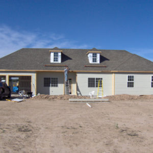

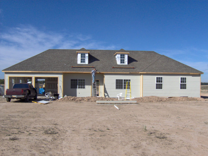

          9. Johnny1985489 | Nov 26, 2005 05:33am | #23
            Well I already bought the windows so I plan to use them. I think it will look fine. I live in the country and do not need 10' windows in this house. Sure bigger windows look better but I don't need to spend a fortune on them like some do. I have more important things in my budget like a home theater! I guess there really is no forumula for window placement, Ill just wing it. Thanks for the responses though!

            Johnny, that is a nice looking house.  But we aren't seeing ten foot walls with only four feet of window height, as we'll be seeing when you post pics of your completed project.
            Window heads are generally placed at the same height as door heads, and with 6/8 door height, your four footers will have their sills 2/8 off floors, which is comfortable and appealing.  The use of 7/0 doors will move window sills up to 3/0 off floors, which is getting up there a little, but still OK.
            But to have 10/0 ceiling heights throughout, or all over your main floor, using 6/8 or 7/0 doors with window heads at the same as doors, you will want to do some ceiling and wall treatments to deal with that 3/0 to 3/4 of overhead above your openings.  You will also need to deal with the "gap" in the way you design and detail the outside of the home.
            What I call winging it is what you have done, and that is to plan for and buy all your windows at 4/0 height, then decide on 10 foot walls, then come here and ask for advice on how to put it together.  Sounds pretty unplanned to me, and that is often a recipe for design disaster.
            People that are not design professionals build houses for themselves all over the place, and many have great success in putting together a composition that works, is livable, and is architecturally appealing.  It just sounds as if you have taken an approach here that most of the others have avoided.  Are you building from a set of drawings?  Can you show us your exterior elevations?
            Let me ask this.  What is it that makes 10/0 ceilings a must?  Will your house be one like you showed in the photo, largely a ranch, with a small area of living under the roof on a second floor?

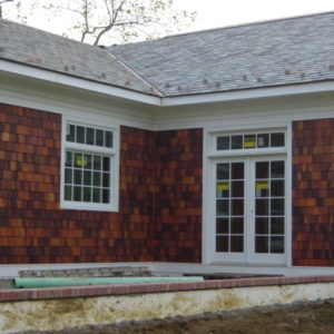

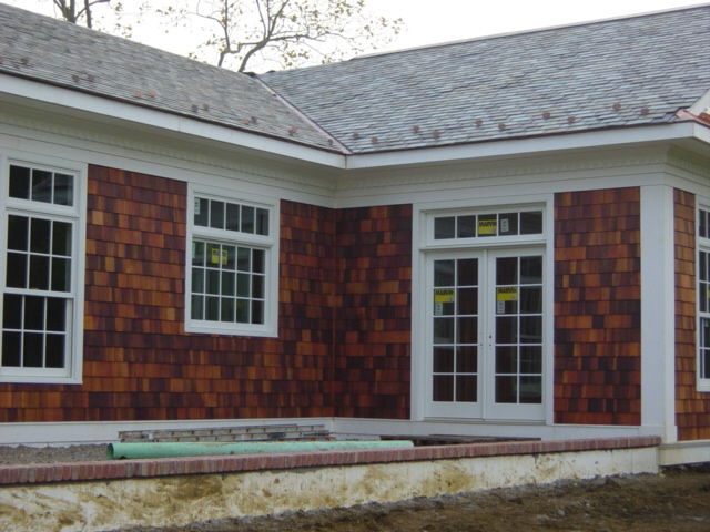

    I my case on the house I framed we had 10' walls and all the windows and doors had transoms over them. We had to set our window height the same as the door height because they all had to line up at the top. So whatever the door height rough opening was, that's what out window height was.
