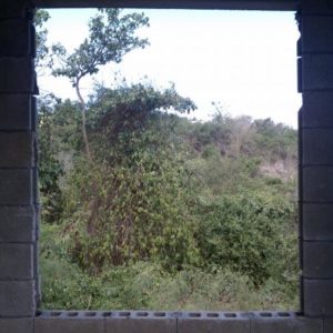

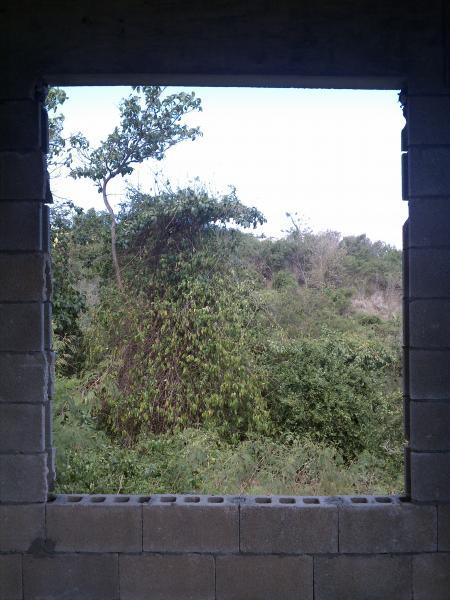

Here is a photo of an unfinished opening:

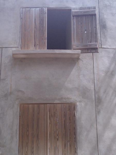

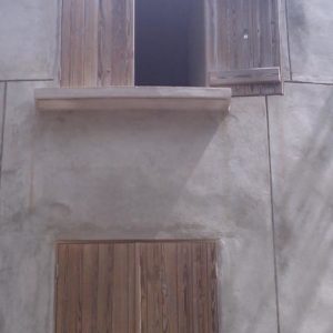

And here is a photo of the type of shutter that I will be installed:  There is no window or screen behind the shutter.  The shutter does have a wooden frame that is visibile in both windows.

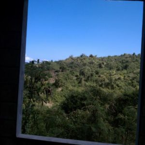

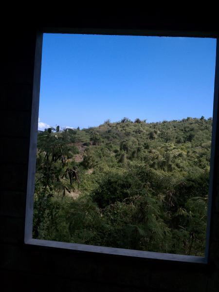

I understand the the first step is to finish the edges of the window as shown in the following photo, this is already underway:

  1. gfretwell | Mar 07, 2013 04:26pm | #1
    I would get the window bucked up to the finish opening size and stucco it, then install your shutters.
    You are not sealing anything for weather so what it looks like is more important than how tight it is.
    I have had pretty good luck just forming up ugly openings like this and filling with concrete. Tap Con 2" lumber on the sides and use drywall screws to put the face on. This will allow you to get pretty precise with the inside opening.
    You start with the "face" of the form open at the top. pour the concrete in, add another board leaving a few inches fill it again and then stuff in the last 2" and cover. Tap the forms with a hammer to consolidate the concrete.
    If you take the form off while it is a little green you can trowel off all the mold marks.
