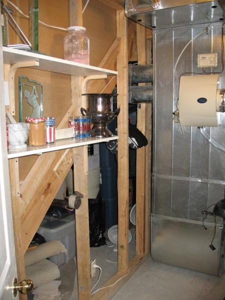

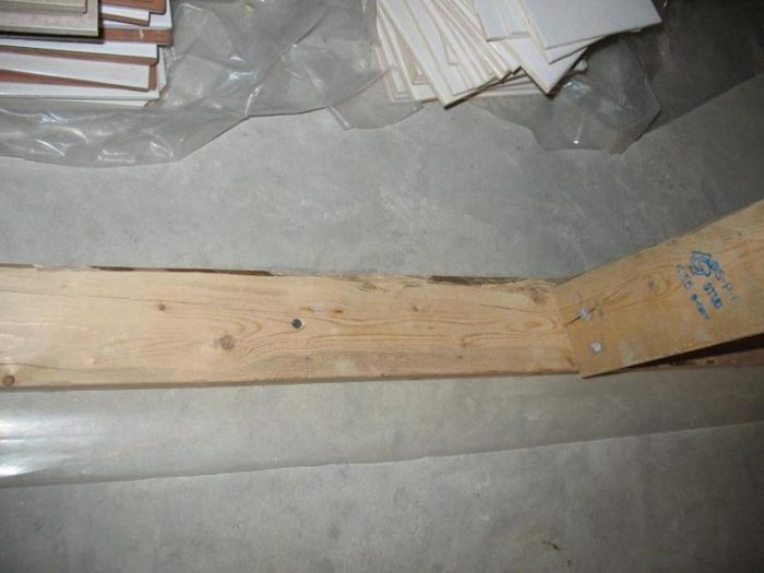

I’m new to this forum… just signed in yesterday. I need some help with bare wood being exposed to my basements concrete floor. It is causing a musty smell there and I would like to stop it but don’t know how. The piece of wood is a 2X4 running across my basement’s concrete floor and is part of my staircases’ load bearing structure.<!—-><!—->
Please see the pictures attached for a better view and notice the vapour barrier is only seen along one side of the piece of wood. As a result, only part of the piece of wood is exposed to the concrete, the other part is correctly protected from the concrete floor. I would like to find a way to protect the rest of the wood (the exposed part) from the concrete so I can fix the musty smell. The smell exists all year round and though I occasionally bleach the wood on top and underneath, the smell eventually (within a few weeks) comes back again. I also run a dehumidifier during the summer, but it also does not do the trick. <!—-><!—->
The other drawback is because it is a load bearing structure and concrete nails were used to attach it to the floor, there is no gap between the piece of wood and concrete – even for something as thin as a small piece of vapour barrier – it just does not slide underneath. It is the only part of the basement that has the musty smell – and you can easily smell it when you lean towards it. The length of the exposed wood is about 3 to 4 feet in length along the floor.<!—-> <!—->
Is there a way to prevent this from happening? I would prefer not to have to take apart the entire stairs structure to fix this problem, but I am open to many options at this point.<!—-> <!—->
Please help and thank you very much in advance.<!—-> <!—->

Temporarily support the load above, and make it tight and strong, you want to pick up on the load "slightly".
Clean off that shelf.
Take a pc of 5/4 composite decking such as trex. That's pretty water resistant and shouldn't crush with the weight (I don't think).
Put that on the floor next to the stinky wood. Put a 2x2 on top of that. Take your sawzall with a metal blade (in case you aren't high enough to miss the nails and it's a thinner blade than wood cutting. Use the 2x2 as your undercut guide. Cut off the bottoms of all those studs and remove the plate and stub pcs (bust or cut the concrete nails in there). Fasten the trex to a 2x4 plate. Slide the thing in there and then toe nail the studs to it. Fasten the plate/trex down to the concrete with tapcons, remove the shoring and put the stuff back on the shelf.

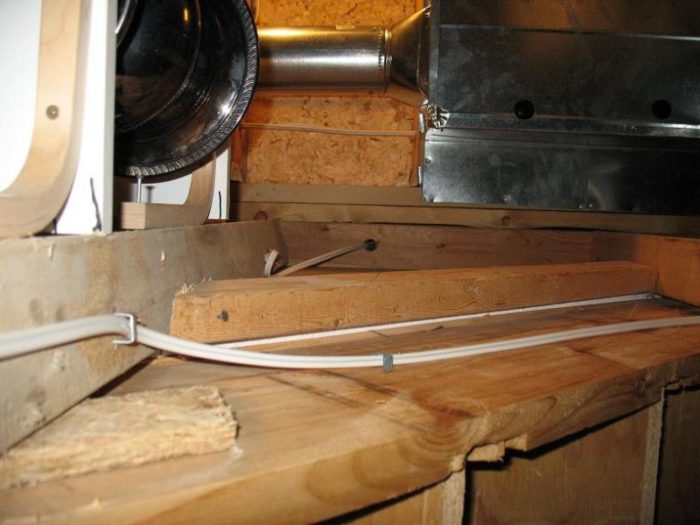

Why don't you take another photo of the up-joist situation. Get as much in the picture as you can. Maybe lie on your back and shoot straight up. We'd want to see any connection of the joists around that stairwell and how the joists sit on any beam toward the middle of the house.

Are you REALLY sure that this is the source of your musty smell? That wood looks pretty dry & new, not the least bit discolored from being wet. Is there any air circulation in this basement? A plain concrete floor in a closed, stagnant space can smell pretty musty after a while.

Rhonda: At least you have tried the simplist solutions, & they failed. Now...
Are you SURE that this wall really bears load? Usually stairs into a basement are parallel to the floor joists, meaning the curtain wall like yours bears no load - or load at only one point along the stair stringers. If the stairs are perpendicular to the joists, they have had to place a header beam parallel to the stairs & all the joists attach to that. This wall looks too flimsy to be a bearing wall for such a header, which would be carrying the load of a VERY significant section of the flooring above. I'll betcha that its main purpose in life is to satisfy some piece of code requiring a railing along the stairs. That stair stringer looks strong enough that it needs no intermediate bearing post.
Now for the DISCLAIMER!!!!!!!! I are not a professional injunear, nor am I a licensed builder. I cannot give you advice that you can cite in a defense, blah, blah, blah. BUT - I can give you some ideas to think about in your own wandering in the wilderness of a messy problem.
Your problem is not the sill 2X4 - it is any water/moisture that comes up under it. You put an impervious membrane under it & you still have the water/moisture. Apparently you don't have a lot of water coming up - you cannot see it. Therefore, your problem it to get it to evaporate before it can grow mold & generate an odor. I still say that the sill looks too pristine to be the problem.
If, in your humble opinion, that wall bears no weight, RIP it out & see what happens to the odor. If you feel it bears some load, figure out where it supports what is overhead, put in a sistered pair of 2X4's or a 4X4 column seated on a Simpson metal post base that will give you some air space under the post. If you feel that you need the entire wall, put the sill in as a piece of pressure treated wood, separated from the concrete w/ spacers made, also, from pressure treated wood. No matter what, you need to get rid of intimate contact between the sill & the concrete. Otherwise you may have to come back & fix your fix!

I doubt that you have a load bearing wall there. Take a picture of the header that the studs are attached to and the connecting beams that they are attached to. I'm betting that you could remove the plate and let the studs dangle without incident.
My thoughts, for what they're worth are that you should just treat the plate with something to stop the water penetration and the smell. There is a product called Cuprinol (I believe) that is used to treat lumber to prevent rot. I would think about really dousing the plate with that--mopping it on with a brush, possibly making a dam to contain it. I'd mop it on over the course of several days, giving it all it'll absorb.
Another thought is to use Minwax wood hardener. It is a volatile, stinky and probably carcinogenic solvent-like liquid. I'd pour and brush that on until it won't absorb anymore.
I especially think you should try either of those ideas first to see if it helps because if you are asking what Trex is and what a sawsall is, no offense intended, but I'd say you aren't really the carpenter-type and doing structural work may be beyond your abilities. I am not trying to be a smartypants or be insulting--we all have things we can do and things we can't do, and I'm a great fan of staying away from things I can't do! (and knowing the difference!) (I for one, never do my own dentistry.)

I am with another poster.
Those 2x's look too clean to generate a musty smell to me.

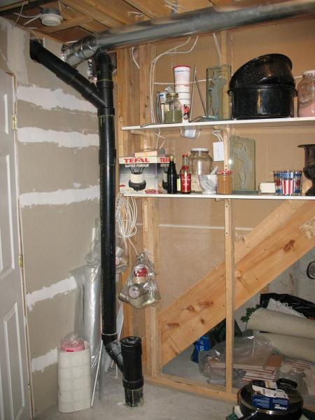

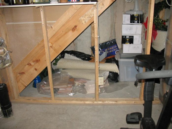

I see a sewer cleanout in the one picture. Are you sure all your plumbing drain lines are sealed up tight?
Is there carpet being stored under the stairs? Get that and any other paper/ wood products out from under and see if the smell goes away.
Most all codes require that all wood be separated from concrete by a barrier or be pressure treated.
If this wall is only holding up the stairs, cut the plate out and replace with a pressure treated plate or jack up and slide heavy felt (30 lb or rubberized roll stuff) under the plate. If you get from nail to nail with each piece of felt and notch around the nail, it will be 98% which should be aok.

I looked at just the first three of the resized photos that JMadson post and I can tell you a couple things: 1) That wall holds the ends of your floor joists at the stait opening--you cannot just willy-nill knock this wall down and play around, you must build a temporary wall inward (toward the picture taker) first. I would do this with one of two methods--frame a wall on the lying flat on the floor with a top and bottom plate and studs, then temporarily glue a second bottom plate to the floor and set your wall on that and use wedges (if necessary) to fix that wall tightly to the joists, running perpendicular to the joists and parallel to the run of the stairs and the existing wall.
Pardon any typos that get through, I've had a migraine since yesterday morning and my typing is suffering from it. In my opinion, an even better way of fixing a temporary wall is to screw or duplex nail a plate across the floor joists, use a plumb bob to find the position for the bottom plate and set it on the floor under the top plate (maybe a little caulk or something to hold it in place), then set guite long "studs" on the bottom plate--these will be so long they will hit the top plate at a fairly good angle--but less than 45 degrees--maybe ten or 20 degrees. Lean them in at the tops in pairs so tops touch and nail or screw tops into top plate. Then use sledge hammer to drive bottoms toward each other until the wall is tight, and toe nail or screw the bottoms to the plate. This will support your joists (floor above). Then you can work on the plate in qustion.
HOWEVER--Don't I see visquean (polyethylene sheeting) under the plate in question? If so, how is this plate getting water from the slab? The plate and slab both look dry to me. I would agree with the poster who asked about your floor drain(s?)--fill their traps with water and see if that stops the smell--smell may be sewer gas!

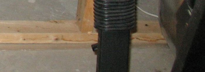

In this picture closeup that you took of the 2x4 sill plate it seems there is evidence of watermarks on the exposed side of the sill that would reveal a serious height of water in the basement at one time but may also have been from the previous attempts of bleaching.View Image
I'd have to agree with the other posters who said they lean towards the idea that it doesn't seem the sill is the culprit.
Moving all that stuff far away from the stair area is a good suggestion as your process of elimination continues.
Is the outdoors area of the basement walls continually damp as from normal soil conditions or water runoff from the gutters being dropped close to the walls instead of led away by horizontally sloped downspouts?
Hopefully it is a simpler answer as was mentioned in an earlier post by lacking a water seal in the plumbing thereby permitting odors to migrate back into the basement or an odor from the items stored there.

My question, still unanswered, from you photo is, what in the heck is that under the plate--it sure as heck looks like plastic sheeting (vapor barrier) to me and so my next unansered question is, where in the bloody heck is this water that's penetrating and rotting the plate coming form?!
ya, she mentioned the little plastic slip sheet and the idea that part of it isn't under that sill on one side and thus the problem
as she couldn't get the sill pry'd up enough to be able to push the plastic all the way under to fulfil the barrier
thus preventing the water migrating to the 2x which is causing the odor.
well, ya gotta love her for trying.
