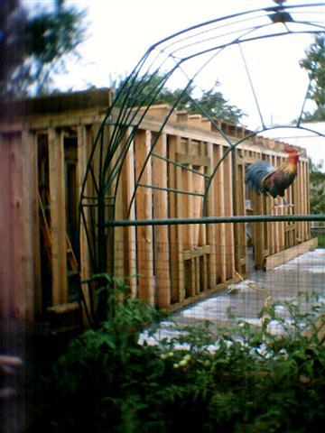

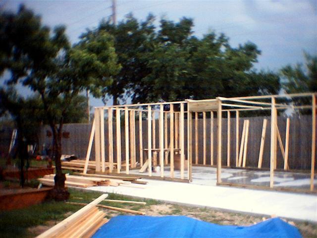

I started framing a 16’X32′, two story cabin/shed the first week in May. Since then, we’ve had rain, rain, and more rain…
The framework has the required pressure treated lumber in every place that touches concrete and galvanized nails were used. The 3-1/4″X .131 brite nails used for all the boards above the base plate are rusting and slight runs of darkness now streak down the wall studs.
Is there something I should be doing or looking for while all these storms and inches of rain come and go? Nothing has bowed or twisted, so far, but I’m concerned.
Here’s a shot or two to show how the wood is darkening…

I would keep working on that whenever possible, get sheathing and a roof on it, help keep the sun and rain off of it. Technically the rain won't hurt your sawn lumber but the I joists don't like much. The sun will warp your studs when it comes out. Gotta work in some wet weather, I'm afraid.
Maybe a little late now, but we are putting a 28 x 64 second story addition on my son's house and the first items I had them buy were 2ea 30 x 40 tarps (and since then 2 more 20 x 28). The job is in NE Florida and we have managed to keep the biggest portion of the rain out. The other post was right, when the sun does dry it out you will probably have considerable warping.
Good Luck
With I-joists one of the biggest concerns would be mold growth. Engineered lumber supports it like a Petri dish. You might want to consider treating (spraying) them just after closing in, or just before (if you can keep them from being wet again).
Get a rain coat and keep workin ,it aint gonna dry out until after the roof is on, then ya just gotta make sure its dry before insulation. You'll be ok , get that roof on.Rik
