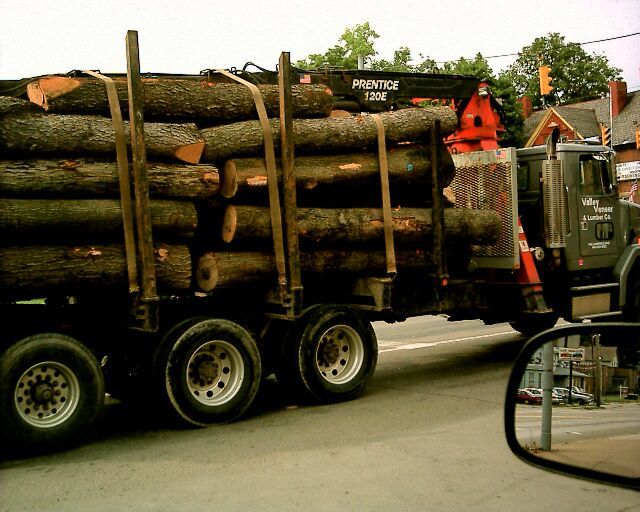

We see these trucks everywhere:

The truck is heading to a small logging mill where the logs will be off loaded.
The logs have already been purchased from the landowner. This particular mill also runs a "stumping operation", which means they cut a deal with the landowner for the right to "cut and take".
The landowner is the first participant in this process, since he owns the raw material. He is also the person who takes the least risk, as there is plenty of competition for his logs, he'll hold out for the best price.
The logger/buyer has to speculate the future cherry market, measure each individual tree to determine number of board ft., cut and haul the logs to a rough mill....and hope he didn't offer the landowner too much for the trees.

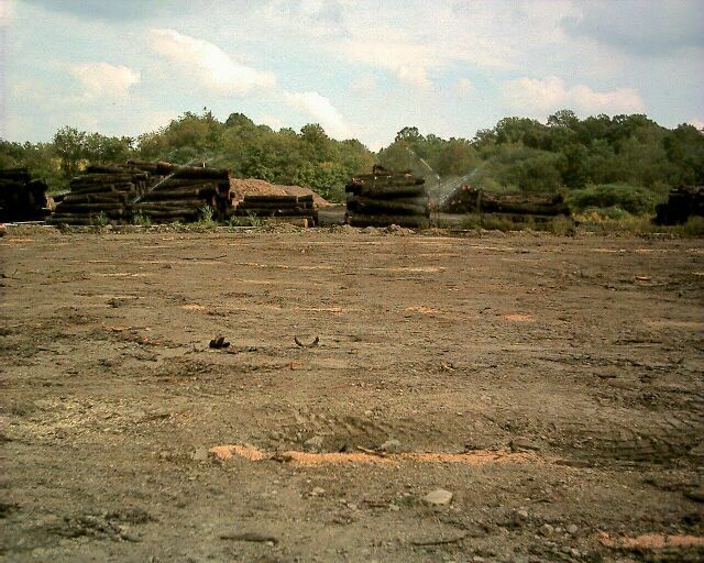

Interesting, my sawmill just waxes the ends of good logs.. I wonder which is cheaper, sprinklers or wax?

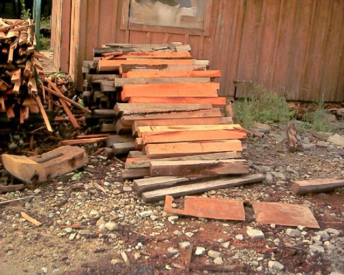

BTW. Your an inventive chap, can you figure out what to do with the piths? They're used for blocking, and burning in the shop stove.
Ditch
Edited 7/9/2003 4:51:02 PM ET by luvditchburns
Edited 7/9/2003 4:51:28 PM ET by luvditchburns
Piths:Ditch
I am not a builder but that was fascinating......Thanks......My husband used to be a cabinetmaker......
Ain't that a shame? my sawmill will have a pile like that over fifteen feet high after a day of sawing and it all becomes firewood...
What does your sawmill get for a pickup load of those? The cost at mine for a heaping pickup load is $30.00 there will be slab wood, heart centers, and pieces less than 4/4 thick in there..
If the piths don't become blocking they end up at local campgrounds as fire pit wood, as do the limbs from the "stumpers". Mom and Pop stores and KOA campgrounds get $20.00 for a small bundle of piths.

Veneer grade wouldn't even get that close to a sawyer as it is turned right from the log. Up here in Maine when I got some veneer grade oak my buyer will come and tell me what lengths he wnts me to cut and off they go to the big Knife at the mill, at times I've seen red oak veneer grade logs go $1200 a thousand. Nice picture essay what a great way to educate the uninformed, I'm still droolin just thinkin about gunstocks and what else I could do with that pile of material. Do tehy use Doyle rule or Bangor rule to scale I'm just curious or biased.
The pic of the sprinkler operation is primarily a veneer operation where they have a peeler. Ditch
