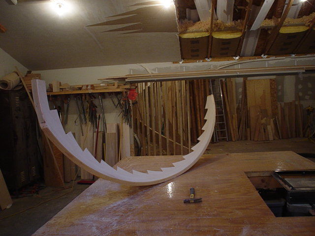

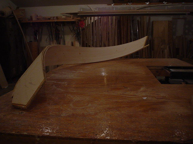

I have been slowly catching up with my stairwork since the July 13th storm. I am now back on the 180 degree maple stairway. Today…I mitered and pocket screwed the inside stringer…and lay out and mortised the outside stringer. The first picture is of the inside stringer just released from its forms with glue runs still on it. The second one is after the miters were cut.

Nice pictures, keep em comming.
I always look forward to the end results!
Awesome. Ditto on the keep 'em coming!
Clutter? What clutter?
Those stairs are starting to form up nicely! Keep the pics coming, I like the before, during, during, during, during, after.

I finally got back on my maple stairway. I have 11 treads installed in these pictures. I thought I would show one as it is "hatching out".
Huh. Never thought of pocket screws! Am I correct to assume these get dismantled and transported??

Hook: Yhe stair will stay assembled except for the railing. You can screw them into the house.
Geeze, Stan, you make it looks easy! Can't wait to see this one when its done. Find a way to turn the stingers into segments and you could mail stair kits to people.
Is this stairway going to get transported with the stringers, risers,and treads all assembled? A hoist in the shop would lift it to put it on the trailer, but I'm curious how many guys it will take to unload it. And it would be neat to watch you get it through a 36" door.
