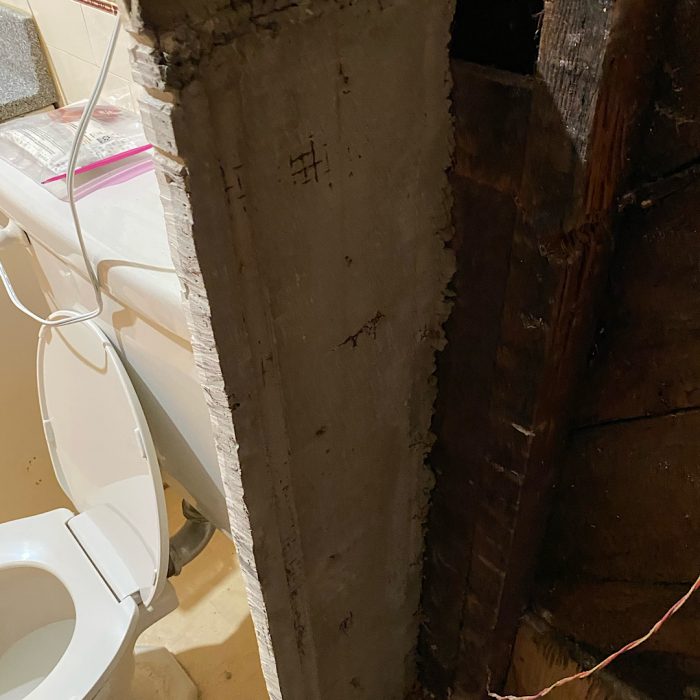

I’ve done it before, no fun. I have about 20 linear feet’ of 48″ high tile on mudbed over wire lath nailed to studs. The tile is porcelain (I think) subway tiles. Building is 1903, but I’m thinking this may be from the 20’s or 30’s. it’s beautiful work, I’ve been able to save it through two previous remodels (the cut you see I did with an abrasive blade in a sawzall maybe 15 years ago- not fun) but it’s finally gotta go.
Seems like the consensus is angle grinder vertical cuts one side of each stud, try to pry off each 16″ strip as intact as possible. Any other suggestions? I’m OK with using my 4″ grinder, but it won’t get all the way through the 1 1/4″ (hoping it’s that ‘thin’ everywhere). Should I get a bigger grinder? I’d like to avoid the mess and stress of trying to remove the tiles first…

I used a 4" angle grinder with a diamond blade, and a helper holding the shopvac hose. Had a powerful fan in the window, with another window opposite open for good cross-ventilation. Also had a carbide demo blade in the sawzall, which worked suprisingly well. I was able to make vertical cuts next to each stud with the grinder, sawzall where that couldn't access, then pry out each section with a 36" bar. Behind the tile, each stud bay was bridged by 1x material nailed to cleats to be flush with the studs and the lath nailed to that, so it took some muscle to pry the mudbed away. Much easier, IMHO, than chipping it out, I could (barely) carry each 'section' downstairs to the truck, then to the dump. Gotta say it was certainly a durable installation method, it was in suprisingly good shape for being 117 years old!
