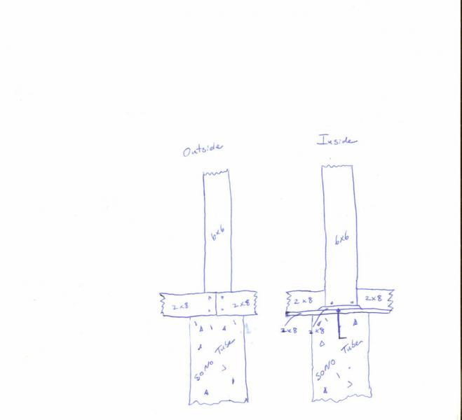

The architect spec out ABU66R because the building inspector would not allow the way that I have done it in the past. See attached (post anchors without ABU66R). The post was just toe-nailed to a double 2X8. Remember this is rough cut so a 6X6 is 6 inches by 6 inches.
Initially, I thought the post anchors would be less than $10 per post and I need 30. However, they are almost $30 but since I do so much business….., I can get them for $20 each!!! Still $600 for post anchors?
Does anyone have any ideas on how to save $600 and increase the hold down power? Thanks

According to the Simpson Strong Tie website, that connector provides 2300 lbs of uplift? And you need 30 of them? I would think an embedded strap(s) would give you sufficient uplift numbers. I would look through their catalog and find something equivalent and then go back to the architect or engineer.
That is a really good idea since ABU66R do not come in zmax and would need to be custom dipped. So it is $20 per plus dipping, or start cutting ice guard in crazy shapes. Thanks for the advice.

How about just an L-shaped piece of steel imbedded in the concrete with a straight blade sticking out. Slot the post and slide over the blade, then thru-bolt a couple or three times.
