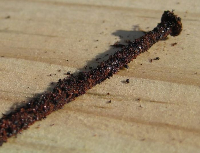

I know there’s been a lot of threads on this, but I thought this was an interesting photo.
I’ve been putting up a fence and found out the hard-way that one should NOT put the posts in the ground before they dry completely (the back 4 panels are a bit wavy, needless to say).
So, today I hauled all the posts out of the garage and stacked them up on spacers outside to drive for a few weeks. In doing so, I picked up one post that had a regular nail that just happened to be sitting on top of it. The nail must have been sitting there for 3 weeks and this is what it now looks like:

Hmmmm. Not too sporty.
Just curious, has your weather been rainy or dry while that nail was sitting on the post?
I'm not surprised by the rust - I am surprised how even it is on all surfaces. I would have expected heavier rust on the bottom (contact) surface. It must spread rapidly from the point of contact - splash during rain?

Actually, this was inside my garage the whole time.I'm using SS and the triple-dipped ACQ approved screws for the fence. The problem is that I can't find SS nails at regular hardware/big-box places unless you get it by the bulk contractor-size container.
Hope everyone sees this.
So to confirm, this standard nail was sitting inside a garage on top of an ACQ pressure treated post for 3 weeks and this is what happened?

Well, to be fair, it MIGHT have been closer to 4-5 weeks. Either way, though, yea, that's pretty much it. Had the fence posts stacked in the garage. Brought out some cheap steel nails (for the record, while these aren't brads, they're only the next step up...so not terribly large nails) to nail in some temporary string holders to create a level line between posts. In doing so, I dropped the box and obviously missed a couple nails that fell into the pile. A month later, and this was the result.
Yikes, were there any tools stored in that garage? Could it have attacked the heads of nails in nearby framing? Can you find all your cars? If not are there any big piles of red dust you don't remember? ;-)

Like the old saying goes, "One picture is worth a thousand posts from a hundred threads here on BT."
Seriously, I've got to save that photo in case any body questions why I want them to spring extra $ for SS.
I think that blows the argument - "They're fine as long as they aren't exposed to the weather."

"Could get interesting in a few years."I can see this becoming the next bid lead/asbestos lawsuit when the decks and houses start collapsing suddenly.
