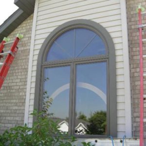

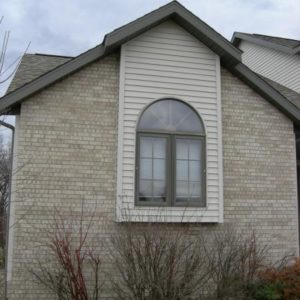

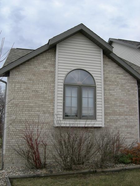

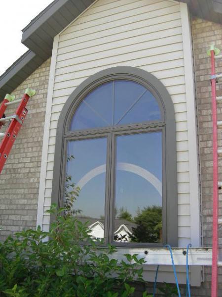

    There is no need to remove all of the siding to install the trim.  Snap lines on the siding where you want to cut, say 2-2 1/2" from the window and use a plywood blade backwards in a circ saw.  Set the depth just deep enough to score the sheathing and the siding will come right off.
    I did this on a window replacement last year. I'm not a big fan of J-channel so I ripped 1x6 in half and attached that around the window.  A second 1x4 was applied over that and then it was wrapped in coil stock.  (You could use azek for the second layer if you wanted white)  This concealed all of the cut edges of the siding.  Windows were flashed prior to installing any of the trim.
    Here is a before and after photo.
    You cannot convey tone in an email.
    1. NoQuarter | Sep 13, 2008 10:12pm | #11
      That is a great explanation. I like the technique and the look.I’m not clear on what you mean by wrapping it in coil stock. Does that mean the second layer has a brown aluminum covering the wood?
      1. vintage1 | Sep 14, 2008 01:24am | #12
        yes. we wanted to match all of the other trim on the house and match the windows (Andersen 400 in Terra Tone)
        So we used Rollex, bronze aluminum coil stock to cover the 1x4.  If you go this route keep in mind that you cannot use aluminum coil over treated wood without a separation barrier.  In this case, we opted for wrapping non-treated with tyvek.
