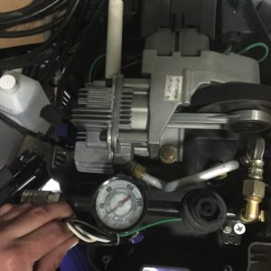

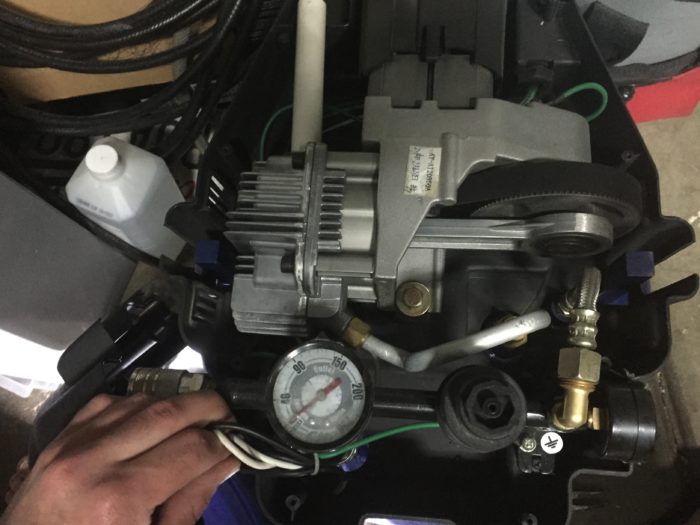

Is this the pressure switch?(first pic)

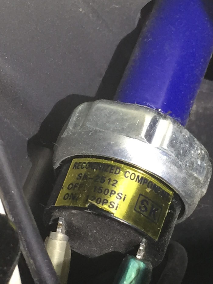

based upon the second pic it looks like to me it should be fairly simple to make it a pig right?
First picture is the pressure switch. The pressure switch looks like the type that would be easy to replace with a generic car air horn pressure switch like this one http://www.amazon.com/Fafada%C2%AE--150PSI-Pressure-Control-Compressor/dp/B00X39M8P0/ref=sr_1_11?s=hi&ie=UTF8&qid=1432115404&sr=1-11&keywords=pressure+switch+120v+120+150 but it is rated at 12v 3.5a. It may be a direct replacement for yours, or not. I looked but did not see any like that rated at 120v. But it could be made to work with a 12v power supply ($2 or so at thrift stores) and a 12v relay with contacts rated for your compressor.
Making it into a pig should be easy, but there's always something to ruin your day. I would remove the compressor, and connect the incoming airline to where the compressor went. Hopefully that will be easy, and the threads will be compatible.
