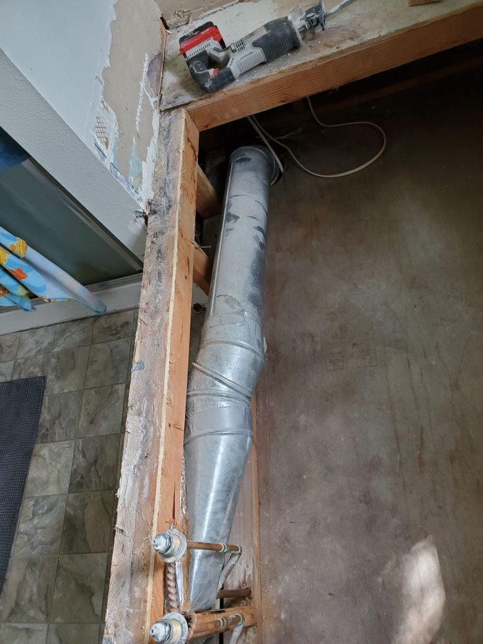

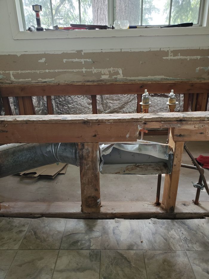

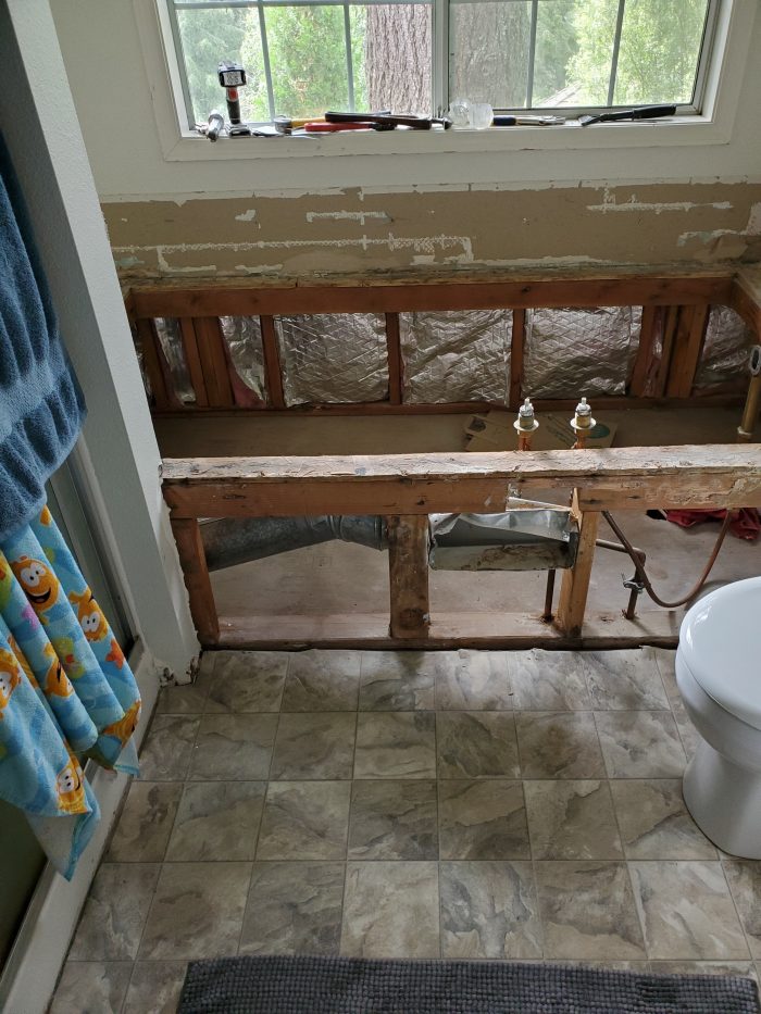

Hi all, so I am starting a master bath remodel and I removed the old drop in tub from its surround. Inside the surround I found this air duct coming from the floor and ending into the wall of the surround. No air comes out when I turn on my ac from any zone in the house. Any idea what is going on here and why and what I should do with it? Thanks!

This is a 6" supply duct with a now destroyed (and probably covered) register boot, it looks to be 14x3. Since there was no air coming out and it was presumably covered, you can cut the duct and put a cap on it as close to the main as you can get. I am an HVAC engineer and I have seen thousands of things like this, and I promise you it is a supply outlet. If you are ok with not having it in that room it will not negatively affect the system - it will just try to push a bit more air everywhere else. I don't like outlets in the toilet unless you can damper them down some, because you want as much negative pressure as you can get with the exhaust fan running. Additionally, the exhaust fan draws conditioned air from the hallway into the room. Sounds like this one is disconnected or dampered shut upstream of this room, meaning you won't notice any difference at all, and you can basically ignore it unless it is in the way.
