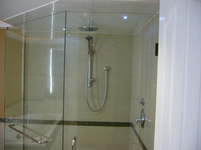

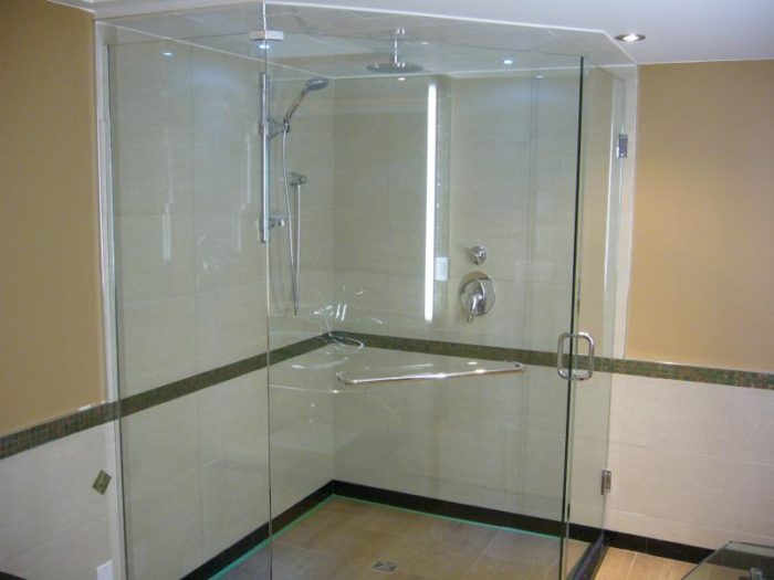

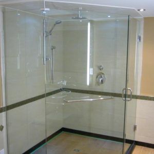

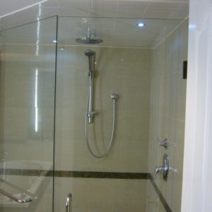

we have waterproofed the floor with Schluter, installed the tiles with almost flat slope to the drain. Then installed a 1x4 granite "plate" over the tiles, then glass walls on top. Sealed all joints and advised customer to seal granite occasionally.
This system may not pass inspections in certain jurisdiction since they might still be hooked on the 6" curb system.
Looks nice. How did you seal the granite plate to the tile? Are you concerned with water wicking back under the granite?"Put your creed in your deed." Emerson
for the plate I used liberate silicone, both for adhesive and for sealing. Since granite is porous, a waterproof finish is recommended and should be maintained throughout
