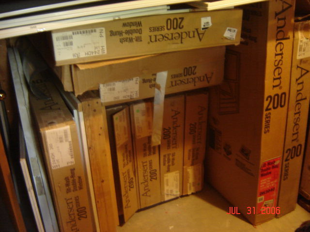

Paid about $30 each for the following w/screens. 22 of them fit real nice under my basement stairs. I think what ever Rez has I caught!
"Paid about $30 each for the following w/screens. 22 of them fit real nice under my basement stairs. I think what ever Rez has I caught!"LOL!!!If I had any place to put anything, I'd catch it too!But I've got so much junk, there's no room for merchandise!Rich BeckmanAnother day, another tool.
