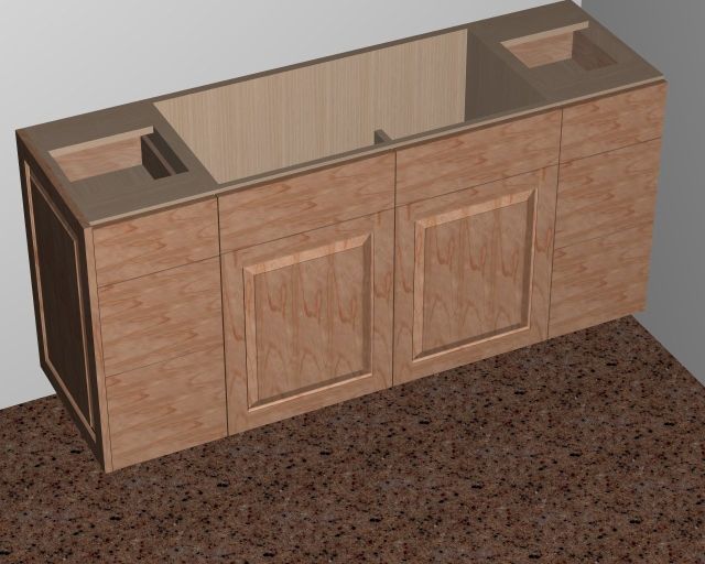

The pic shows a straightforward bath vanity, which is built using frameless construction. That means it is three separate boxes, ganged up. If done in faceframe construction it would be one large box with a faceframe, and a couple of stretchers and braces.
Overall size is 60 3/4″ w x 32″ h x 18″ d.
There are six drawers, all with slab drawerfronts, two false drawerfronts, two hinged doors, and a door panel is used to dress the finished end. The toekick and endwall scribe filler are not shown.
The six drawerboxes are dovetail construction, done using 1/2″ baltic birch, top edges edgebanded.
With the outside finish and species being white pine, some knots OK, clearcoat, toekick to match, what is your cost for a unit like this? Please state your figures as cost and not sell, and say whether you are making or buying, and if doing some of each, say what’s going on.
I am asking because I think I am buying this as right as I can, boxes all CNC cut and KD, all solid wood stuff included in the package. Assembly time for the kit is one hour, to have cabs ready for installation.

For others that are still reading, the attached pics show material usage for doing the carcase and drawerbox part of the job in frameless boxes.
This pic shows how about 1.5 sheets of 3/4 stock plus less than a half sheet of 1/4 stock are used for the carcases.
This pic shows drawerbox material usage, the first one being the 12mm (1/2" nominal) material for sides, and the other sheet being the bottoms.

A quick phone call to a cab dealer down the road yields this.
A semi-custom shop two states from me will do it all in pine, clearcoat natural, and the quote through this local dealer is $515 plus tax, my pickup.
If from Kraft Maid, a well-known national brand, it has to be birch, because KM stopped doing fronts in white pine. $640 plus tax, my pickup.
Neither of these prices includes a stile and rail end panel, as does the config in the pic in the first post.
The package bears a cost of about $400 if bought as a KD kit, with tax, freight, delivery to site or shop all included. The end panel is included.
