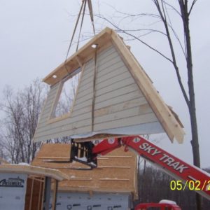

            EDIT: I FORGOT TO POST THE PICTURE: IT'S IN THE FOLLOWING POST.

            Here's a wall that will be set on the second floor. I rememer this wall well, because it took an hour to set it because it was out of reach of the crane. It's a side wall. When I teach a rookie to layout a wall like this (if a guy lasts a week on my job, I'll be teaching him how to layout the wall within the first week), I explain all the reasons why we might have to stack the studs. I'll show him that this is a sidewall and there will be NO HEATS running up through it. There will be no pipes running up through it. There is no seismic hardware running through it. It is a self contained, independent wall.
            When we finally analyze the wall, and decide that we have free reign to layout the studs anyways we want, we talk about what we can do to help ourselves as framers. Instead of insisting on some needless "stack the studs" mandate, I challenge them to start the stud layout from a spot that might give them an advantage as they assemble the rest of the wall. I challenge my guys to be thinkers, instead of ordinary.

          4. blue_eyed_devil | May 22, 2006 07:09am | #21
            Here's the attachment.

            That wall didn’t look that big. If you knew the crane couldn’t get to it and you were going to waste, why didn’t you just build it on the deck and just lift it up with an extra pair of hands?
            That wall isn't that big and the crane can easily lift it....until I boomed down past the point of tipping! I knew it would be heavy when I boomed it out as far as I had to go, but I misjudged the weight and if I had stubbornly proceeded without changing my techniqe, I would have tipped the crane over and layed it down on the house. When the outriggers leave the ground behind me, I'm smart enough to slow things down.
            The easiest solution would have been to grab the wall with that Skytrak, but I chose a differnent method and it ended up taking us some time to get the wall position safely. The Skytrak would have posed some different challenges (tight muddy working conditions) so  no choice would have been easy.
            As far as rasing it by hand....that's a lot heavier than you think. It would be simple with two walljacks, but I wouldn't raise a wall like that by hand anymore. I haven't done that in ten years and I'm not going to start that again. My back is shot from being a Superman and I don't wish that on any of my young protoge's.
