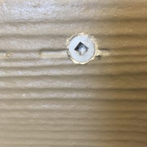

Yes, these will be painted after installation, but I still want a exterior rated screw. I had thought of using a cement board screw, but I have two issues with them.
1. The displaced material fuzzes up around the head.
2. It takes a ton of power to sink the screw so you really need to predrill. Predrilling may help with #1, however I really don't want to predrill 5,000 holes.
I'm not familiar with the second screw option. How will perform in relation to my two items of concern?
Options
I don't think that you will have to pre-drill. I have experienced what you are talking about with the "fuzz-out", don't think that you will find a way to get around that. There will always be some displaced material with screwing cement board. Some samples might be in order for a trial, feel free to request some.
Do you have any idea how fast you can sink stainless steel ringshank nails with a siding gun? And they will not pull out, they probably hold better than screws. No fuzz either. Just smooth heads with no driver holes or marks. And you can buy a great siding gun and a box of nails for probably a good bit less than a box of screws. Screws definately have their place, but nails flat out work.
Well, that is a drawback of nails. Normally I don't plan on removing siding, but if the screws are for a special application, that's different.
