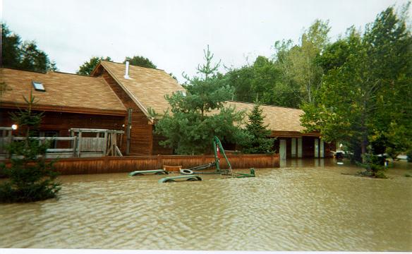

This may not be much help. I had a home in a flood zone, we experienced two major floods in three years. Bottom line, we cut our losses and moved to higher ground. It's not worth the aggravation if there is any chance of flooding.

Our old home has been returned to nature. The stress and financial losses associated with living there are not worth it. If you have an opportunity to build elsewhere do it.
