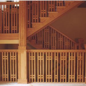

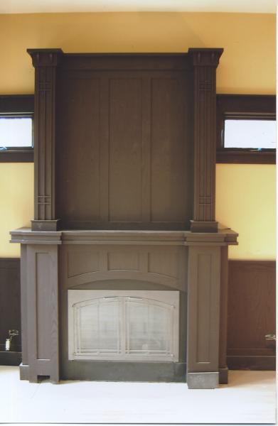

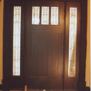

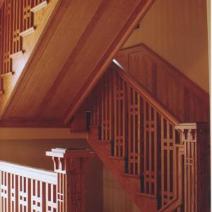

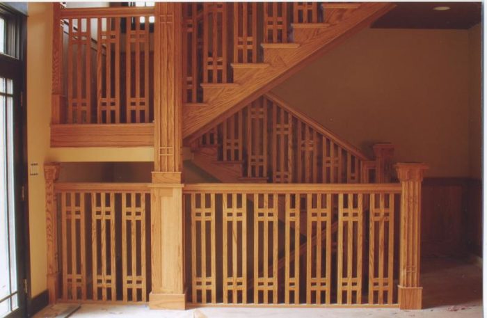

A few more photo’s from the Arts & Craft home front. Be more than happy to get a little remedial photo file downsizing advice to make these pics a little more manageable.

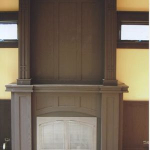

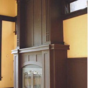

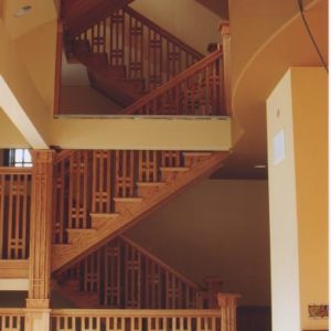

Here are resized and brightness corrected images.

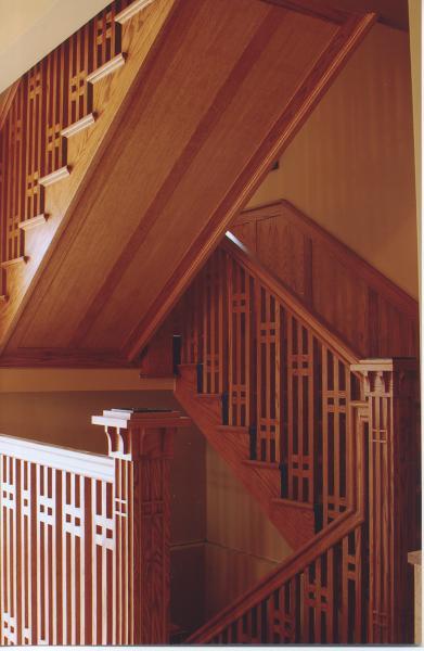

I really like picture #6, showing the whole stairway- nice work.

JRuss,
What is the context of these photos. These photos of yours are great. Is this your house? I may use some of them for inspiration in my own major home remodel.
JRuss,
Is this your house? If so, nice job -- looks like you've been busy!

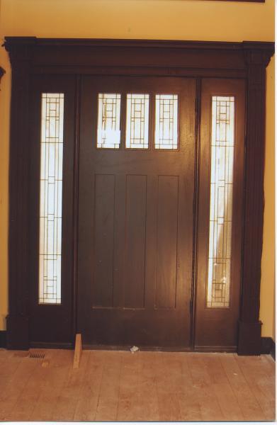

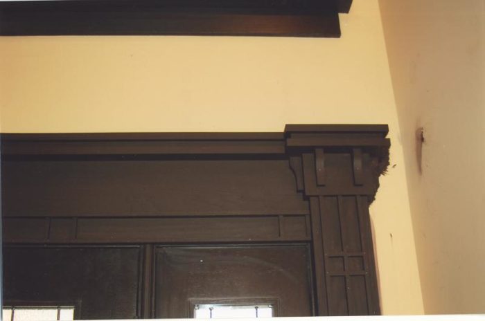

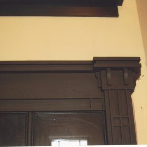

In a number of photos, I noticed some smudges on the walls from staining. I have a tip to offer you that I learned from some painters (maybe you can put it to use in some areas where you haven't already completed the trim). BEFORE you install the trim, put up some masking paper (see the attached image). Note that the paper runs under the trim by two inches or so. Just use a little blue tape, and then install your trim in the normal fashion.
When you get around to staining and top coating, the paper will protect the walls. When you're all done with the top coating, use a new razor knife to carefully cut away the paper. As long as you don't really saturate the paper, it will completely protect your walls.

Really nice work. Great attention to detail.
We'll redo the walls in this area, we just came up with the entrance surround idea at the last minute, the painter wasn't trying to be careful.

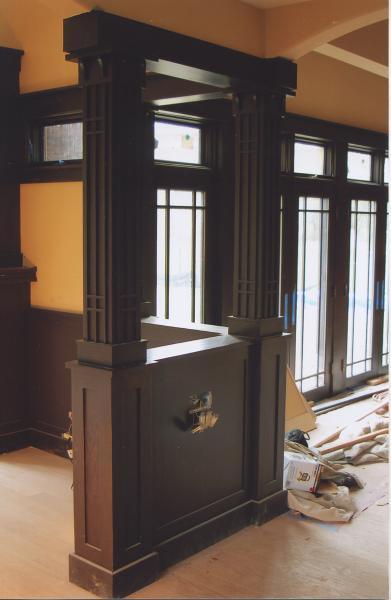

I'm building the house for a Chief of Neurosurgery. There was no interior detail, we told him we has a few ideas, he's added a couple of twists, and away we went. The arches, barrels, trim, stair, etc designs came from our empty little heads. Everything but the cabinets was cut, milled, and assembled from flat stock on site.
The real credit goes to an owner that will let you do something like this. A very very rare bird as I'm sure you know.

Really nice work Russ...so tell me...were you sick of it by the time you were done? Reminds me of when I made all my fences...I never wanted to see another picket for the rest of my life...lol. All the repitition...ugh
How'd you figure out the cost? Did you charge him T&M or did you figure out the job as a whole and if so how'd you figure how long it was going to take you and were you on the money by the time you were finished?
How many of you shared in building that? Was it just you?
Real nice work!!

We're still at it. Not the stairs but other trim work. And yes it's time for it to be over.

Beautiful work, Jim.
Much thanks Jim. Most of the credit goes to Patrick the fellow who was with us in NC when we met you and the gymnastic champ.Never serious, but always right.

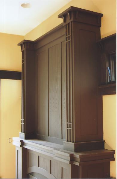

Yep, it's Kathy. We design together, I and we cut, mill, and build assemblies, Patrick installs the stairs. He also built the mantel. The newels have 80 pieces the column 100. I'm the general he's the carpentry contractor. So that relieves me of knowing anything.PS We'll be out to tackle the Dragon again in May, I'll buy the cobbler.

You missed the posting...we sold that house and moved. We're in Winston-Salem now. A real estate boon that we couldn't resist and opportunities here for Meili that surpassed those where we were.Great work on the stairs and trim...have a great trip on the bikes!
Just gorgous work!Hey, my boss & a couple of his friends are going the Dragonthing in May also! Small world.Why Germany? Kindereier & Pantofeln THAT'S why.
