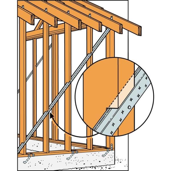

    1. calvin | Feb 25, 2022 01:58pm | #5
      Here’s metal bracing from Simpson.
      There are a couple different kinds, what we were used to was a “T” shaped metal.
      Been so long I’m foggy on how often to use between corners……study up at the Simpson site for code approval.
