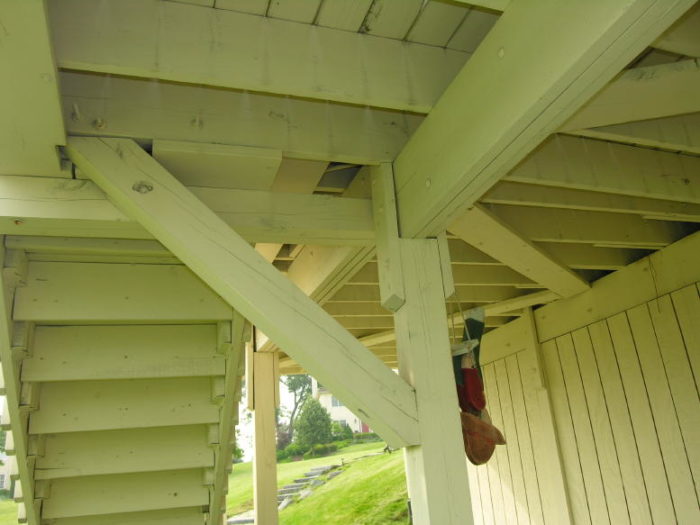

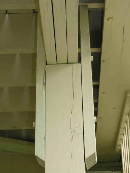

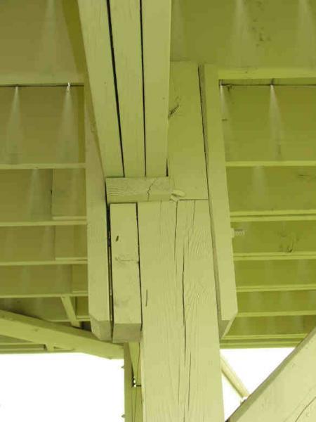

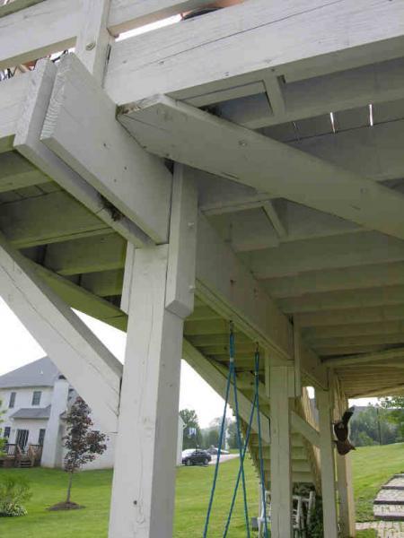

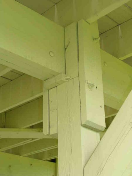

Bad deck building, check out the pics. Check the light at the top of the spindles!

It looks like they framed the deck, then took all the leftover scrap and just found places to nail it. LOL.... that's just awesome.

Looks like a typical 25 year old deck with many coats of paint. Treated warps and shrinks...nothing earth shattering there. Nothing looks unsafe in the structure to me...not the best choice of joints.....but not unsafe by a wide margin.
from the couple I opened everything looked loose ...
but looked like it all stacked up.
beams over posts, etc.
doesn't have to be pretty to not fall down.
I've seen way worse ...

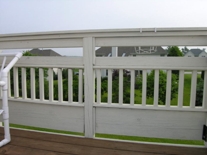

Did you see that the top of the balusters are not actually attached to the rail?? That certainly doesn't seem safe to me. It's the last few pictures. You can see daylight between the top of the balusters and the rail.

But did you see how much railing is over those little 12" balusters? It's not like you would walk over , put your hand on the rail and fall over. Those balusters are for looks only.
I'm not argueing it's a cobbled job, and a huge waste of lumber and time....but I also would not want to be the guy demo'ing it also. That looks like a bite.

Understood. I guess I'm thinking of my 3 year old cousin running into the balusters with a full head of steam. I could see him plowing right through the little balusters and over the side.
"Those balusters are for looks only." Maybe in some bodies imagination!The railing or qny portion of it should withstand a lateral force of min 250#

Just kidding. You fixing it? I like the offset post with the spacer block, classic.

Seems like maybe the most convoluted method of deck building I have ever seen, and definetly fugly, but unfortunatly, will probably stand up on its own for a bunch more years. I am not saying, however, that those railings are going to hold people from falling off the deck!
Structure looks OK, but sloppy. I would suggest a complete redo of the railing, and perhaps the "cleated" stair.
