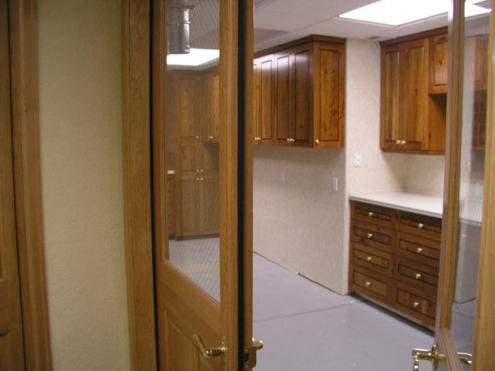

Order your shop entrance door with an exterior frame. Comes with weatherstripping.
Like this:
Edited 6/12/2008 11:08 am ET by peteshlagor
