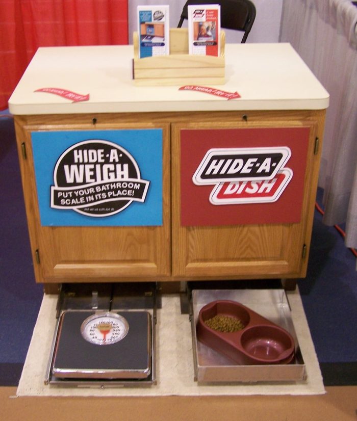

My father-in-law, now 83 years old, invented such a drawer in the kick space of the cabinet for housing a bathroom scale. Named the "Hide-A-Weigh," this drawer opens and closes with an electric motor. He holds a US Patent on his invention, and is presently trying to license the patent for manufacture and marketing of this product. The inventor worked in construction for over 60 years as a private contractor and carpenter.
The patent allows for considerable flexibility: the device can be used for housing a bathroom scale, a dog's food bowl, as a gun safe, or any other possible use of the space. This product is compatible for new construction, remodel or retrofit. If you know of a manufacturer that would be interested in licensing this patent, please refer them to me at this website. All of the specs for the "Hide-A-Weigh" are included in the patent documents. The price for licensing the patent is $100,000.00 USD, plus 10% of all future sales.
