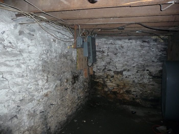

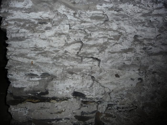

Hello! I am looking for a home, and one prospect has a stone and beachsand mortar foundation. circa 1880
I'm wondering how your project went, and what you ended up doing?
Also, who is the contractor you mentioned in Newport who does replacements?
I've attached 2 photos of the foundation of the home I'm considering - if anyone has any reactions, I'd be interested in any suggestions or opinions.
