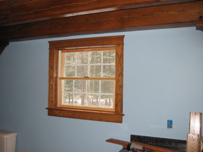

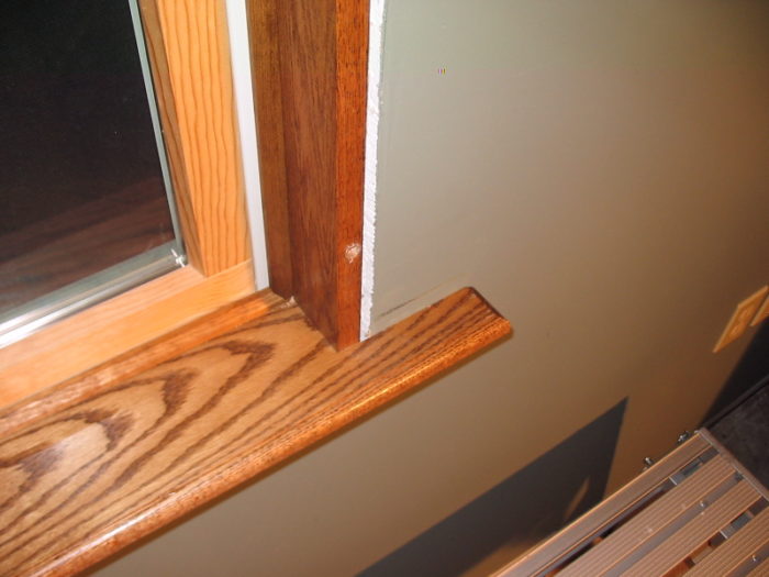

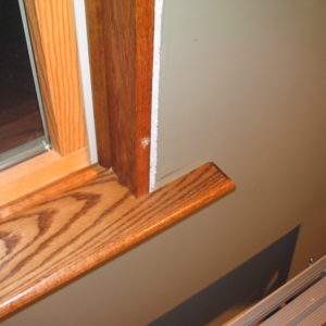

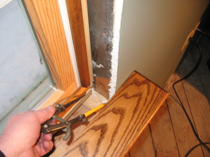

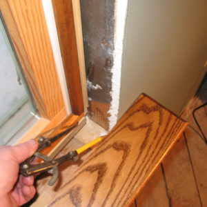

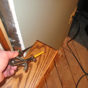

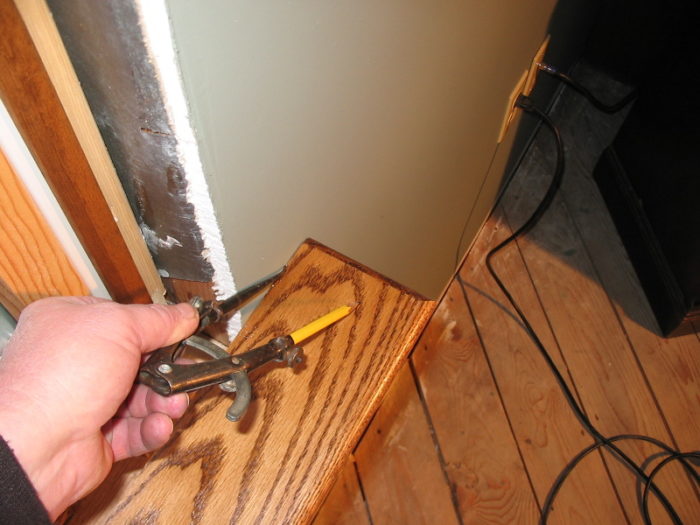

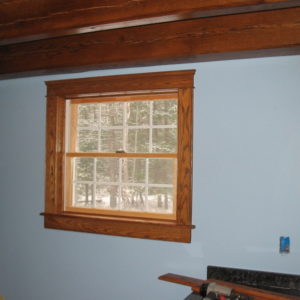

    I have some pictures of a trim sequence for a headcased window. This one required an extension jamb. Unless you are in a remodeling situation, where there is a significant variation from jamb to drywall, I don't scribe much more than the sill, so the ears fit tight to the wall and the window. You can use dividers, like in the pic, or just measure.
    I trim houses for a living. I don't get to take my time. I try to keep it simple and repeatable. The more you whittle on things, the more it shows, instead of being clean and neat. All windows that are the same size should take the same size head, sill, etc. With new construction, and people that know what they are doing, there isn't much need for scribing in things. I have done some gawd awful remodels where you need your thinking cap on, though. In these cases you may need to rip out strips that either go on the jamb or flush with the edge of the casings. Typically you use the same species. You may have to rip 1/4" thick strips, for example. You can keep them flush or stepped out for a secondary reveal. Sometimes, these may have to taper. Hopefully your job isn't that bad.

    Note that, in hammer1’s pics, the stool is actually longer than the head casing. That’s because the stool extends past the side casings by the same amount that it sticks out in front of them. Which, with a nice, deep stool, is larger than the reveals you use up top.
