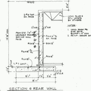

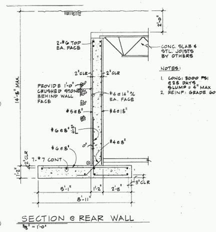

Learn something new everyday. I wonder why they spec the 60? Especially in Virginia.

Take a peek at a Grade 60 spec:PAHS Designer/Builder- Bury it!

That drawing was for a residence, mine.
