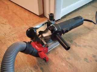

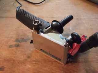

First of all – instead of a spring-push method, it has a pivot/plunge type design. It also has a fence and can ride an edge and do grooving, like drawer bottoms, cabinet backs, etc.

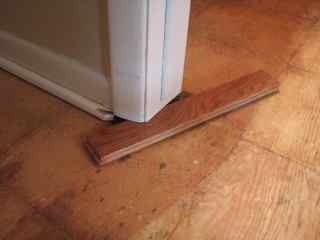

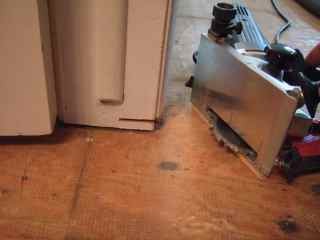

Most importantly, it can adjust the horizontal height of the blade a fair amount – something most bisuit jointers cannot do. This function, combined with the ability to adjust the blade depth way deeper than most (little more than an 1″ depth of cut and great dust collection makes this the cat’s meow for jamb and casing cutting for floor installations.
This sucker cuts fast and clean and no dust or mess. Even with the door stops in the way, it has enough depth to mostly cut all the way through the jamb board – enough that you can chip the middle scrap right out of there.
