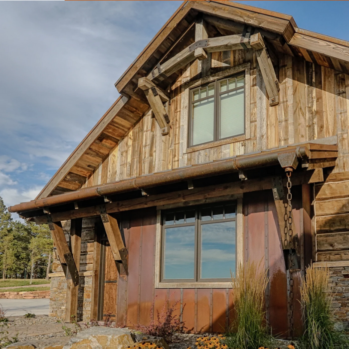

    Here is my take on your solution. You don't need any framing on the exterior. Seal the gaps in the logs with a liquid flashing and apply 3 inches of polyiso foam board in two layers to the exterior. The first layer has all the seams tapped and the second layer has the seams offset from the first layer and again tape all of the seams. Apply furring strips to the exterior insulation on 16 inch centers or farther apart but nor more than 24 inches. The furring strips are screwed to the logs through the insulation. Yes, you can add some screws while you are putting on the insulation. You use larger diameter plastic washers so the screws don't sink into the foam.
    Then I would cover the exterior with thick board siding that resembles cut and shaped logs with a tongue and groove connection. Another final covering option would be steel siding. There is a place up in that area called Bridger Steel. Check out some of their steel siding options. The furring creates an air gap so that any water getting between your foil covered insulation and your final siding can get out. I would also add a bug barrier layer to the top and bottom of the air gap. There are synthetic materials that would work as a bug shield but one that will last forever would be strips of Rockwool. The space is usually 3/8 to 3/4 inch so you would cut strips about two to three inches wide and the thickness of the space. Rockwool will allow water to pass through it as well as air and vapor. But if bugs try to bore or burrow into it, the rock fibers will destroy their exoskeletons and they will dry out.
    The great advantage to the exterior insulation is that warm wood means healthy wood. Any natural moisture in the logs can get out by moving into the rooms.
    If there is any chance of wildfire, then the exterior insulation should be Rockwool Comfort Board. Comfort Board will not burn or support combustion. Even with Rockwool you will still want to use an air gap behind any siding. The attached picture is metal siding.

        I suggested a thick board siding because the edges can be cut to create a log look or a nickel gap siding look. In the picture I attached of the metal siding, you should know that the siding above the window/roof overhang is metal too.
        If you are willing to cover the exterior log look, then consider using corrugated metal for siding. There are examples of corrugated metal in the vertical as well as horizontal positions and how it is applied around windows on the Bridger Steel website. The other thing that is nice is corrugated is very strong and stiff without being thick. It is also attached through the surface and that makes it easy for the DIY owner. Just use stainless steel screws. The corrugated is also available in many surface colors as well as galvanized or galvalume.
