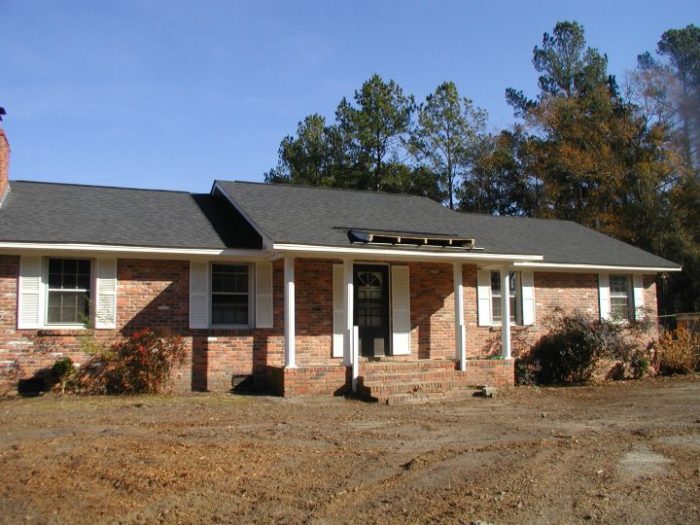

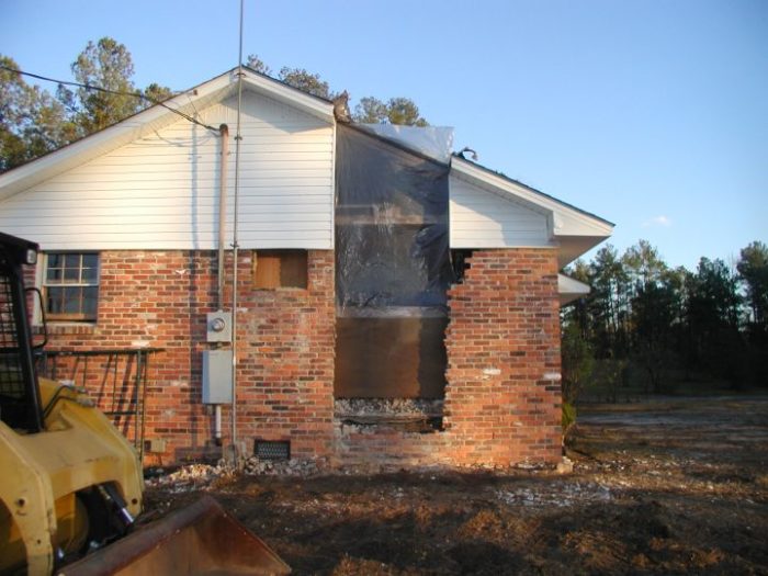

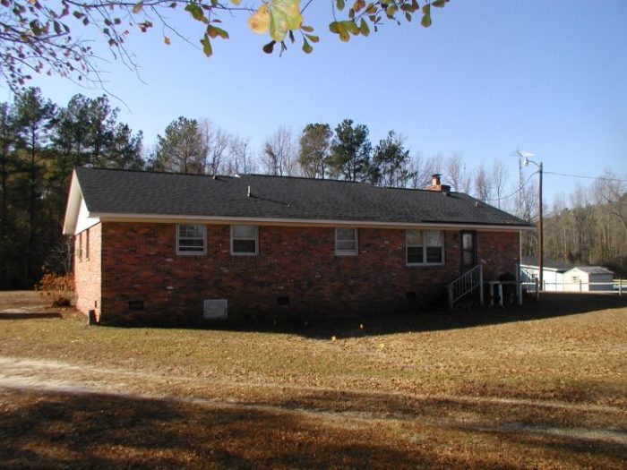

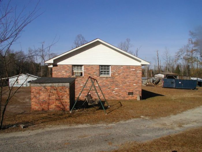

I’ve gotten a couple of estimates recently to re-brick the house. The bricks are badly chipped and cracked and we want a different look anyway. The brick we’ve decided to use is a queen size brick, so it’s fairly slim. One of the masons who looked at the job is encouraging me to just leave the old brick in place and lay the new brick right over them. The pictures I’ve attached (familiar to many here) show vinyl on the gable ends. This mason says he would remove the vinyl and carry the brick all the way up to the eave vents. He impressed me as someone very confident and knowledgeable. However, he did caution me that it might require some additional footing and that I would have to tweak the exterior trim to accommodate the new brick. I’m replacing the doors and windows anyway, so I’m assuming that I could address the fit to the new bricks during installation. The only remaining exterior concern would be the vinyl soffit, which I could either trim to fit or remove entirely.
Bricking over the existing brick would certainly save me the hassle of removing and hauling away the old brick and tearing out the gabled walls that are sitting on top of them. However, the other mason who quoted the job says that bricking over the existing bricks is a foolish notion that just wouldn’t work.
I’ve pretty well made up my mind to install new bricks but I’m not sure how to proceed on this. Is it really necessary to tear down the old brick before installing new brick, or is bricking over the current brick a reasonable option?

Rookie answer ... you're going to double the load on the brick ledge and increase the load on the foundation. How will he attach the brick ties? The doors and windows will now be about 4 inches more recessed. Sounds like a bad idea.
i'm going with the bad idea vote. so your new windows could be set out,but then you have interior problems.seems to me you just chase one thing then another. i had a neighbor remove his brick,wasn't real hard just time consuming. if they didn't break up i think you could sell them. if not find someone laying a new gravel driveway ,they make good base. larry
hand me the chainsaw, i need to trim the casing just a hair.
You will have to redo all the soffits with a brick pocket that is ~4.5" further out, and this probably should be done before the new wythe (layer) of brick is added. And, you will have to extend out your footers ~5". They should probably be pinned to the old with steel, etc. Eddie make a good point about attaching the new brick to the old - I guess you could nail brick ties to the old brick, but normally the way multi-layer masonry is tied together is via ladder wire, which is impossible at this point. I'm going to go with the bad idea vote too.

A few other thoughts: Really wild guess, it sounds like you are talking about $20k. Is this really going to raise the value of the house that much? It probably will, if the neighborhood will support it and if the final product is significantly improved. IMO, if you rebrick it (regardless of if you do the tear-off or not), the house will still looked dated, unless you make some other significant changes. To me, just changing the brick isn't going to do that much.
Like how about doing something with the roof line? Maybe a forward facing gable over the front porch, and making the porch a foot or 2 deeper? I guess you have to redo all that porch and step brick anyway? Maybe adding a bump out (cantilever) with a picture window on one side?
I bet if you started a separate thread asking for suggestions on revitalizing the exterior you would get some good suggestions, and maybe even some that were not too costly. Sometimes people here take your pic and electronically draw right over it to give a visual representation of what a change might look like. Can't hurt to solicit ideas. Obviously you will be making the budget decisions... If you do solicit ideas, you might want to state what style you would like to go for or how your tastes run: colonial, georgian, contemporary, transitional, traditional, etc, etc.
