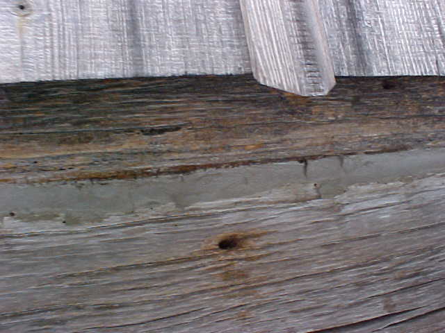

I've done quite a bit of B&B - good points above, expecially the batten attached to the nailers and not the boards -
a couple of suggestions - might want to profile the battens (refer to pict) - a touch more rerfined and makes things lay better, altho with your high end material it doesn't look likely to be a problem - the other is to plan the installation carefully - beside doors and windows, secure a plank and then rip material to fill in the space above/below - a drip edge on the battens and boards as exhibited in the pict is suggested -

hi erik, - - I've always used roughsawn for siding - looking a that Ipe mock-up, well, too much - - for us common people, the quality of siding/batten boards sometimes leaves something to be desired - if the battens tend to 'wild', then anything to remove some of the tensions will help it lay and hug the siding; planing, beveling, cutting the battens out of the quarter grained boards - I dont think you can count on B&B to stop much wind, and wind driven water that gets behind the batten runs down the edge of board - really a good design to shed water, as long as the trim is designed and flashed correctly -
so I guess I think that there is not much point in planing unless the battens are lumpy, and if they are lumpy I wouldn't use them for anything but a barn -

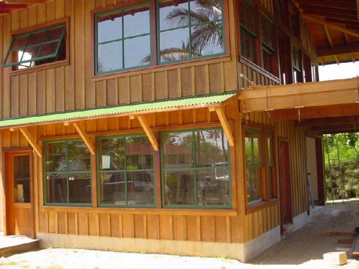

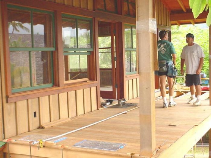

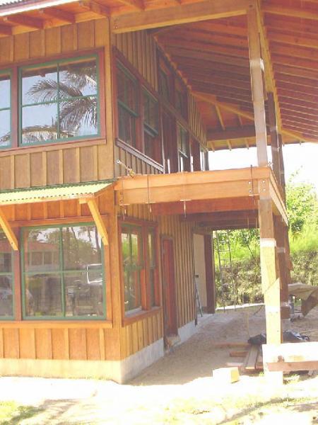

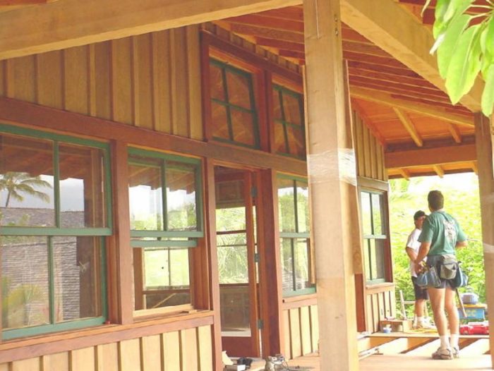

Aloha David. Been a while. These are some pictures of our guest house. Now getting ready to head for the big one. Ipe siding and decks . Nothing but slow.
It will last. Trim is Ipe with a oil for minimum up-keep, but some show. Later, Sluggo
wow - - heckuva job - thanks for the picts - - with all the overhangs, it doesn't look like the siding will experience much weather - did you build the frames for the windows too? whatcha going to do for corner detail? - - keep us posted -

Hi David. Corner Trim will be the 1' X 2 1/2" battens, with the 1/4" reveal like at windows and doors. As for the windows and doors, they are made by a wood-working shop here on Kauai. They are all redwood. Wait till I get some pictures of the main house. Start on it soon. Sluggo
