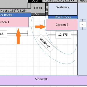

2) Dimensions: Garden 1 (4 walls) = 20′ x 4′; Garden 2 (4 walls) = 13′ x 4′; Garden 3 = 29′ x 3′ (2 walls and back against fence).
3) Base: a) Dig a trench 12″ wide x 4″ – 6″ deep; b) Compact soil; c) add 3/4″ “clear” crushed rock and compact to 2″ below grade and level.

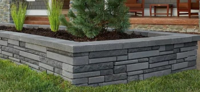

I have attached my plan as well as a picture of the planters I want to build (mine will be much shorter).

    I like the soil fabric against walls but don't think it's needed on such a short planter. Any water that gets through is going to drop rather than migrate horizontally. Wall is too short to pool water - unless your existing landscape drainage is poor. Does your existing landscape drain properly?
    Cap overhang is 1.5" - 2". Anything more looks like a shelf.
    Investigate using stair treads as a cap. Longer runs will look better and might be the same price. They may not come 8" wide but you can trim it yourself and pop the edge detail, or make the wall a bit wider. An 8" cap is pretty narrow.
