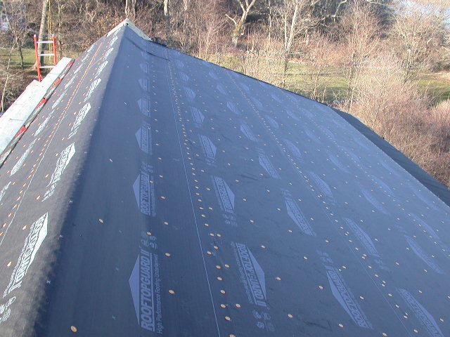

we felt our roofs in first... we use a synthetic felt on the roof , like RoofTopGuard II, or UDL
then we put pour windows & doors in... tehn we felt the siding as we goMike Smith Rhode Island : Design / Build / Repair / Restore
