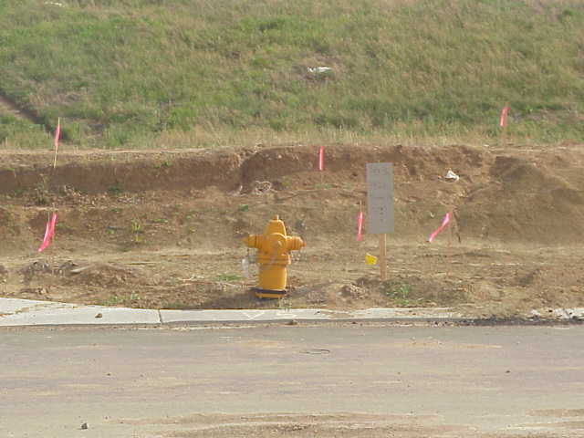

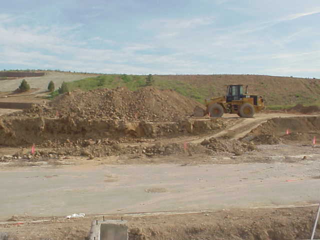

Thought I would share some of the daily activity of the goings on @ the local job site.
Friday building was staked out, (along with 2 others). Excavating finished by 4pm.
