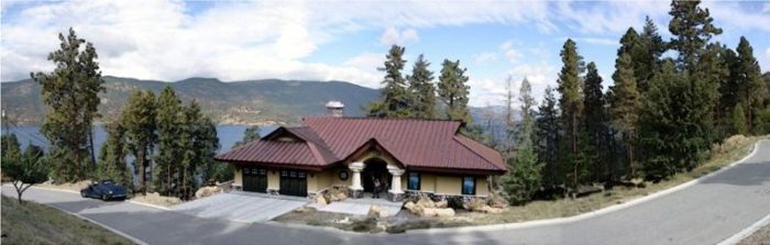

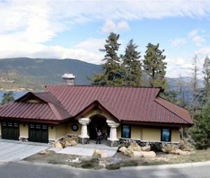

I’m building (I have a general contractor) a new home with craftsmen design features. One major feature is a pair of over sized craftsmen columns at the front entry. After reviewing several photo examples I have developed the general design, size, scale etc. They will be a tapered square columns about 5′ plus capitol, about 2′ wide at the base with a stone faced lower section about 3′ high. Probably non load bearing. I’m hoping to do some of this finishing myself. (for the fun of it and some $ savings???)
I’m looking for construction details, materials suggestions etc. I found one small article in the Fine Homeduilding archives, describing a plywood box model that could be scaled up.

    Could you post some of the other pictures you liked?  Or a close-up of the columns shown?  (BTW, that is the UGLIEST entry I've seen in a looooong time! Looks like it was designed by Hanna/Barbera -  Hey, I know its not yours, its just the columns you liked!  But I just had to get that out)  How about an exterior elevation drawing of your entry?

    1. fartherhome | Feb 11, 2006 10:46pm | #4
      Ha! ,You expresseed exactly what I was thinking,but didnt want to say. It does look like something from the flintstones, dosent it?
    2. DougU | Feb 12, 2006 12:48am | #6
      Yea well what they lose on the front entry they gain in scenery around back!
      1. brownbagg | Feb 12, 2006 03:26am | #7
        yes but check out the blue car. 2+3=7

  5. maverick | Feb 12, 2006 03:40am | #8
    I'm thinking your GC wants no part of building columns like in the picture. Can't blame him.
    1. stinger | Feb 12, 2006 03:52am | #9
      Why would you say that?  The pic is of a built house, and some GC, somewhere, built those columns we are seeing.
      The top capitals look a little out of scale, and the color is wrong, IMHO, but otherwise, things look in keeping with the overall theme.
      Note they are not oriented to the front elevation, but are rotated 45 degrees.  This theme is probably repeated in the foyer, and the great room's orientation to the rest of the mainfloor.  Look at the chimney.  Same orientation.
      I like a standing seam roof, but the contractor that did this one should be shot for making such oversized hip cover flashing caps.
      Edited 2/11/2006 8:02 pm ET by Stinger
      1. maverick | Feb 12, 2006 04:00am | #10
        I like the house, the columns however look like they belong at disney land.
        1. stinger | Feb 12, 2006 04:06am | #11
          Re Disneyland, to quote Miles Davis, "wuz wrong wid dat?"
          Architecturally, there is garbage everywhere.  But the Disney folks almost always get things right.
          Been to Celebration outside Orlando?  How about Epcot?
