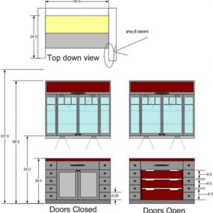

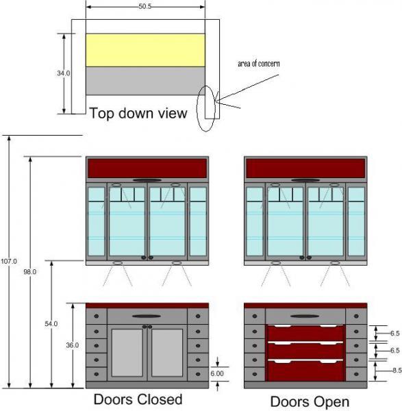

I’ve built my first set of kitchen cabinets but now i’ve got to build a “built in serving area” and i’m seeking advice how to handle something. See the attached picture. My question deals with how to handle the bottom where the 1×6 baseboard intersects with the cabinet. The build in sits back a good 8 inches from the front edge.
The built in cabinet will not have a toe kick (unlike the picture) but will be more like a standard piece of furnature. I suppose this also means that the bottom part of the cabinet (where the toe kick normally is) will sit out 3/4″ beyond the face frame and have some kind of molding above it.
How do you handle the intersection of the baseboard (stained cypress) with the bottom of this cabinet (tigerwood)?

    What is the height from the finished floor to the bottom of the drawer?
    If your base height is greater than that heigth you can't run the base around the corners. The drawing shows either a full overlay drawer fronts or framless cases. Both could present you with a problem when the drawers are fully extended if those corners are even just a little out of square to face of the units.

      i can have the drawers sit off the wall enough so that they won't hit trim on either side so i don't think that that will be an issue. Also i haven't decided how tall the bottom trim on the cabinet is going to be yet...i could have it 5-1/2" (same as the cypress) but that may look too tall.

    1. BobC | Apr 29, 2007 07:31am | #6
      So if i hear you all correctly, it would look something like this? With the baseboard and the built-in apron being at different heights -- say 1/2" different?
      1. Jer | Apr 29, 2007 02:49pm | #7
        You got it. If it doesn't look too out of proportion I would build the cab base a bit taller and let the house die into it. If it's too tall on the built in, then do the opposite. 1/2" is too little a difference IMO, it will make it look like they almost meet. Go with an inch.
