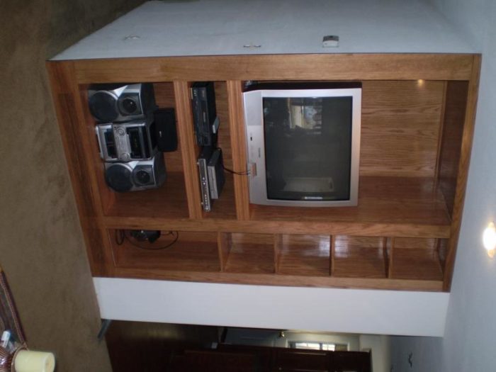

Here are a couple of pictures of the completed TV cabinet that I recently finished. Thanks to all you that helped with ideas and answers.

How did you make the grill in the bottom?
and this time I'll actually add the photo...
thanks for your picture help.
Grill on bottom was about an hour of layout, measuring very carefully the distance between each place to cut out and where to keep material.
then I drilled 1/8" holes at each end of channel that I was going to cut out.
then I stayed sober and fired up the Makita 7 1/4 circular saw and plunge cut then ripped from hole to hole. I was very nervous and focused at this point. big sigh when done and no errors.
cut to length.
sanded, finished and then on the backside I glued some casing nails I cut off and used them as spacers between the fins on the long cut .....below the TV side.
It was that simple.
Better yet my dad said it couldn't be done until he saw it for the 1st time yesterday.

Looks nice.
Here's hoping no one runs a vacuum cleaner into the grills.

should be ok there, I usually help with vacuuming. Fins are suprisingly strong for their size....but we'll see when they get older and oak dries out more.

Nice grills, but what are they for?BruceT
cold air returns to the furnace.
