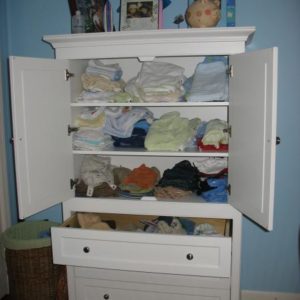

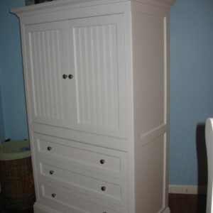

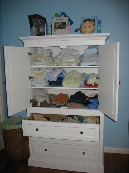

I’ll post one of my cabinets I built for the twins. I plan on building other pieces when there ready for beds. The body is hard maple painted with dull lacquer finish. The drawers are solid maple too. Later on I can remove the upper shelves and place a TV inside. I also carved a message to them hidden inside. I hope they find it some day and that the piece is around for a long time. Building this for the boys was pretty emotional for me. Of all the cabinets I’ve built in the past this to me is the best. Simple cabinet,but very rewarding.
-Lou   Can someone resize for me (thanks)

    Here you go Lou. Nice work.

    Nice job, Lou.
    It's a great feeling making something for your kids.
    Way cool! Nice work too.
  4. splintergroupie | Sep 07, 2007 07:37pm | #4
    <<remove the upper shelves and place a TV inside>>
    What? No flat panel? <G>
    Nice work...and can we hear the message?
  5. CAGIV | Sep 07, 2007 07:50pm | #5
    Looks great Lou, can you explain the finish?
    I'm sure your boys will use it for years to come

      Cagiv, I made a mistake (dont tell the wife)
      I forgot that I used a few coats of a lacquer based primer (Ml Cambel primer undercoater)pre cat. Then I shot it with sherwin williams Pro classic latex. The reason I used latex is that it would be easier to touch up the many nicks it will receive over the years. Even with a foam brush it'll still look great. I used a Capspray hvlp gun setup with a #5 tip I thinned it very little. The finish came up like plastic. I was going for that look anyway. Business pieces I like to show some grain.
      -Lou
      p.s. btw the pro classic line is good stuff. (as far as latex goes)

        I've used SW pro-classic on a few projects, it does provide a good finish product, I'm more partial to BM Satin Impervo though.
        I never had much luck shooting any water borne latex enamel out of our HVLP though.  I shot a lot of Impervo but it was always thinned with Naptha.  Now we'll just use an airless.
        I agree with the ease of touch up, I wanted to use a Shellac or hand rubbed oil finish on the bed I recently completed for my wife, but lost my ambition and ended up with a post-cat laq, hopfully it holds up

          Cagiv, You'll love this trick. I mix some water with plain old nox gelatin when I thin the paint down. It flows nice and keeps the sheen up. But if you want a semi gloss look then use gloss sheen.  Trust me it works. I learned this from an old timer who has been in the finishing business for 60 years.  I'm sure the manufactors would not warrent this.

    Very very nice!
    Might as well build another one just like it, otherwise when they grow up and go their seperate ways, they'll have to saw it in half if each is to take it with him!

    You know... that is really too nice for little kids.  Maybe I should hold on to the cabinets until they're a bit older   ;)

    That is a beautiful piece of furniture.

        Lou, nice!
        But the message is visible. I had to blow it up quite a bit to make it out. I can make out the first part of the message but the end of it is obscured by clothing. It reads:
        "If you ever sell this at a yard sale I'll kick your.."

          Mongo, I dont think they can sell it a yard sale, becouse the thing ways like 500 pounds.

    Hands down one of the best things I have seen on here.   Dallas
