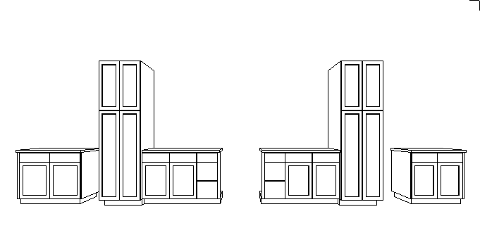

Cabs for four (4) bathrooms. Two have simple vanity sink bases, no drawers. Two have the vanity sink bases flanked by a 3-drawer stack on one side, and a 7/0 tall utility cab (for linens) on the other. Simple and cheap. Exposed cab sides are birch, doors are all shaker-style in birch, and drawerfronts and vanity blank slabs are all solid birch flats.
What is your guess on cost, finished and delivered, ready to install?

The rendering was ours that we gave to the guy quoting it. We prefer to do our own.
We have the numbers, for doing it this way: Cab Parts for the KD frameless boxes and shelves, and Scherr's for the finished fronts, hardware, and toekicks.
$665 for Cab Parts, $1050 to Scherr's, total $1715 for materials. We estimate 4 manhours for assembly. The local yard quoted $1900 for the cheapest version of Aristokraft, with 3/8" sides and stapled-together drawer boxes.

Just wondered what you all would say. The quote from Scherr's, with us puttin' 'em together, is $3000, delivered. Can't ship 'em till June something.
Cab boxes all frameless, sides, floors, stretchers, tops, shelves, all 3/4" melamine. Front edges are taped in a vinyl that looks like birch. Dowels and confirmats at the joints. The tall box sides and the one exposed side of the lone vanities are 3/4" clearcoated birch. Drawer boxes are doweled and screwed melamine. Blum 3/4-ext runners.
Fronts are as you see in the picture, all in clearcoated birch. Hinges all Blum, the "Inserta" kind that require no tools, and adjust like a dream.
My partner thinks the Scherr's $ is way too high, and the 90-day wait out of the question, so I will leave it up to him to bring in something for less, and sooner.
The yard a block from the job can get Aristokraft, and we will see tomorrow what this is from them. The diff will be: face-framed, not frameless, 7/16 sides, a vinyl look on the exposed ends, 1/2" shelving, stapled joints, probably zilch for cleats on the backs.
We can get Kraft Maid from a dealer here in town, but my guess on this package in K-M is somewhere between $3600 and $3800, plus of course our 7.35% tax.
