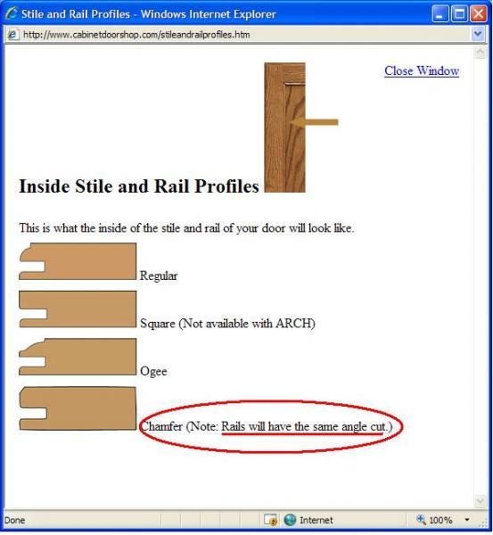

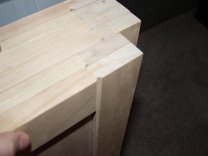

I wanted a chamfer just on the inside stile and rail. The screen shot attached shows what the website describes. And the photos attached show how it was constructed. The chamfer is now a vee grove between the rails and stiles.
Is this the norm, did I misinterpret the website? Or is this a poorly worded description that brought on the mistake?
HELP?
Since that profile has the note on it, and none of the others do, my guess is that is a poorly worded website.
I think that it should have said the the rail END would have that profile.
Becuase, in fact, as noted, both rails and stiles have the profile shown, BUT ONLY ON THE PANEL SIDE, which they also say.

Hard call. They did put the text note in that rails would match.
Their profile view suggests a much smaller, more 'broken' edge, than the V-chamfered profile they actually cut.
Nothing on the profile page to indicate dimension, either (which is middling smart for them; you can't come back and go "Hey, my 1/16" chamfer is a 3/8" cove, what gives!?")
Having seen the finished door the note makes since.
All the other profiles you would expect for them to be applied to the rail and the stile.
If I was ordering the ogee I would not bother myself with the note on the chamfer.
Likewise, if I was buying the chamfer, I would not bother myself with the lack of note on the other profile.
The way it reads is, yeah it has the profile on the rail and stile, duh. That is what I would expect. BUT, having the benefit of seeing your doors, I can see why they have the note now. Though I don't think "the rails have the same angled cut" really describes what you got. (it does when you have the benefit of the picture though).
Perhaps it should read, "This profile results in a v groove at rail and stile joint". (someone may have suggested that).

Just got off the phone with Cabinetdoorshop.com. I guess I just bought 6 doors for personal use.
They said I was the first to call in with this problem. They also said that it couldn't even be done. I know with an ogee or any other profile, a set of rail and stile combination bits is very common. Has anyone ever seen a combination set for a chamfer profile? If so, do you have a link to it?

and you can have a custom shaper set made.I have made a few sets of shaker doors with chamfers but they had full tenons and the chamfer was removed at the joint and mitered not coped.

Have you offered them to the client? Or do they just look to funky to even present the client with them?
TFB (Bill)
doors look screwed to me. chamfer should be around panel only like all others. i have been ordering doors from texas doors for years. good quality fair price
