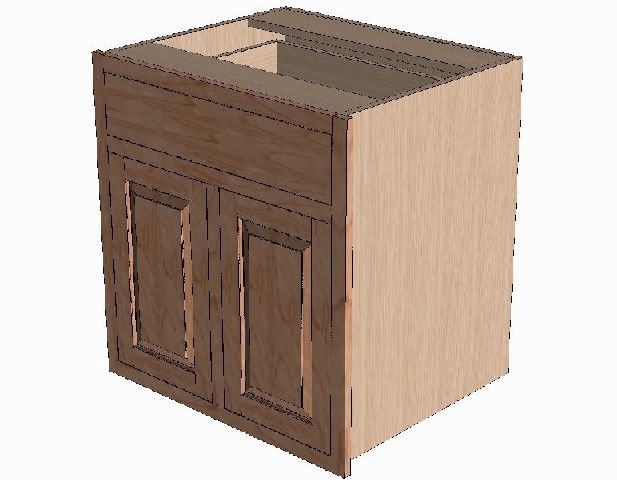

To date everything we have done is frameless, in using this package and its link to CNC parts cuttting, so this is indian country for us.
Blum is our preferred hinge, and it looks like we will use the halfcranked one with 9mm plates. We like and use the 3-way adjustability all the time, when tuning fronts at final.
Blum Tandem is our preferred slide, and this model has the cab sides inside faces flush with the inside faces of the FF stiles. No sideblocks required, and the CNC will drill the 5mm holes for slide mounting.
Two questions for you inset cab pros.
1. What perimeter door and drawerhead margin works best for you? I was thinking 2mm all around.
2. For door close, do you prefer freeswing hinges and some kind of catch, or selfclose hinges and bumper blocks? If bumpers, do you do top and bottom corners, or something else?

I use a margin of a slight 3/32 for my insert doors, you'll have to make the conversion to metric. 1/8 is preferred by some but to me it looks to big, too easy to!
I also mount the FF so that the ff hangs off the cabinet, like you mentioned, FF flush on the inside to avoid the issue with the hinges.

Thanks, Doug. I'm just trying to get ready. So far we have stuck with frameless cab work.
We gotta be ready to compete on all fronts, and if someone wants their doors and drawerheads inset, we gotta go with faceframes. If it is overlaid fronts they want from us, they're gonna get frameless.
Since posting this thread, I went to the Woodweb archives where there is a pretty good discussion of inset fronts margins, and the consensus seems to be at 3/32".
That is a little less than 2.5mm, so if I work the whole scheme in metric, and keep cab widths, FF element widths, and cab heights all in even millimeters, all my fronts parts will be sized at 5mm under opening sizes.
That's perfect for what I do, because the door and drawer folks will all make in metric sizes, and hold tolerance to the mm.
