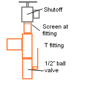

What you need is a simple sediment filter - here is a plan for one. Basicly for every stubout from the wall, you need a T fitting - one outlet up and the other down. On the upside, place a wire screen (faucet areretor screen) in the threads and thread in the short pipe fitting on top of it, locking the screen in the pipe. Attach the shutoff valve to that. On the bottom, attach a short pipe and a full flow ball valve below that.
The sediment will be stopped by the screen, and fall down into the pipe with the valve. When you feel the flow slow, the pipe is full. Put a bucket or towels beneith each tap and open up the full flow valve, emptying the sediment filled pipe.
