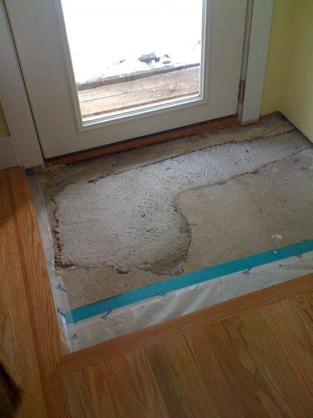

I’m installing tile on a 3′ x 5′ area under the interior side of an exterior door in a bedroom – yep – the bedroom has a door to the outside. The rest of the bedroom floor is 3/4″ oak which has already been installed and finished. The tile floor, when finished, will sit just shy of the oak floor by about 1/4″ to 1/2″.
The customer would appreciate even 1/2″ piece of polyiso on top of the concrete slab so that the slab doesn’t telegraph cold into the room where people will be walking around in socks or even bare feet. We have 1 7/8″ to play with so I was figuring on 1/2″ of polyiso for a thermal break followed by 1/2″ of plywood and then 1/4″ hardie tile backerboard followed by 3/8″+ slate tile and thinset.  TOtal would keep me just under 1 7/8″.  OR, maybe the 1/2″ of ply wouldn’t provide enough stiffness so I could install 3/4″ ply and skip the tile backerboard?
My question is, will this small section of tile be stable? Could I finish the perimeter/junction of tile and oak with a silicone caulk instead of grout?
Grateful for any suggestions.
Thanks,
Don
