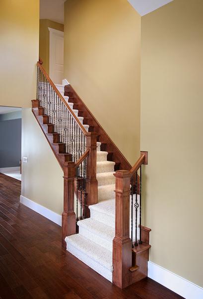

I had just finished a staircase with the false treads kit, and it was carpeted up the middle after I was done – looks great.
So, I have another client that would like the same job in their entryway stairs – but their staircase are fully carpeted now. I’m thinking that the best way to proceed is to remove all of all the existing carpeting and install the false treads and then install new carpet.
The alternative is to carefully cut the existing carpet to allow the new false treads, but then wouldn;t you have issues with the “tautness” of the carpet?
What’s the best way to proceed here?
