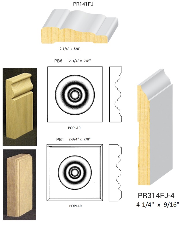

  3. marie1809 | Jul 03, 2021 07:40am | #4
    OK, I follow you about trimming the casing .
    If I still don't like the way it looks, and decide only to use casing on the door, I'm leaning toward leaving the rosettes on the window, because people do look AT a window as they look out. So at least the window will look nice even if the door doesn't look as nice.
    Attached is a pic of what I want to use.
    I'm undecided about the plinth blocks (for the rest of the doors) whether to go plain or fancy, and the rosettes (note the bevel edge) but the dimensions are what I put in my first post. Plain plinth blocks would be easy and inexpensive ... just cut poplar or pine board and [maybe] bevel the edges.
