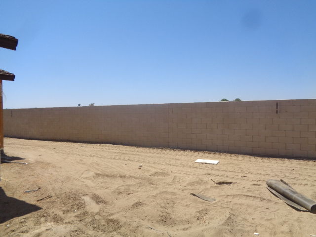

I want to paint a mural on a cinder block wall. I know I need to seal it with exterior acrylic primer (2 coats) but I would like to fill in the grout lines to make a smooth surface to paint on. So the question is, can I fill in the grout indents with caulk and smoothed with a putty knife to acheive this? and will it hold up? I will also paint over it again to seal it after it dries, before painting my mural.

    a parge coating (skim coat with mortar) will fill the grout joints as well as the pores in the block.
    think of a smooth stucco.

    Most good paint stores will sell "Block filler" which will do exactly what you want.

    Ya that one scares me, I have watched viedos that show if you don't do it right...too wet...too dry...it will later peal off.

      Yes, you do have to do it right.
      that is the name of the game.
